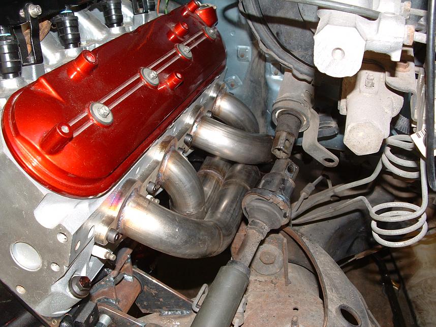

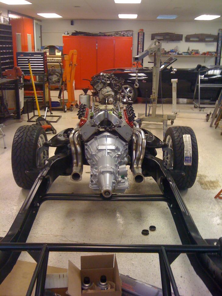

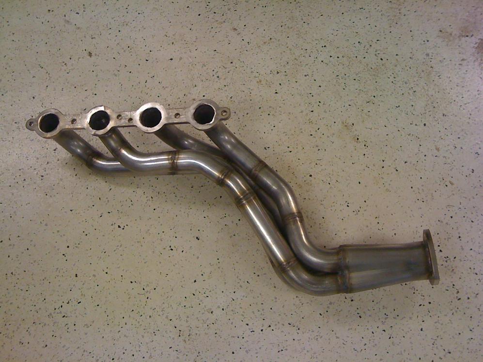

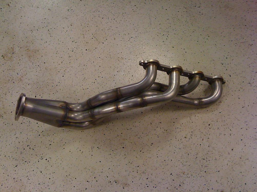

Originally Posted by tobenk
What about makin headers for new 5.3,6.0s for these. Does any of this tubing look famliar? 1 3/4 with 3in collectors. Awesome stuff by the way.
Attachment 53400
Attachment 53402
Attachment 53403
Attachment 53404
This our header builder kit??? Looks awesome send me pics of your build!

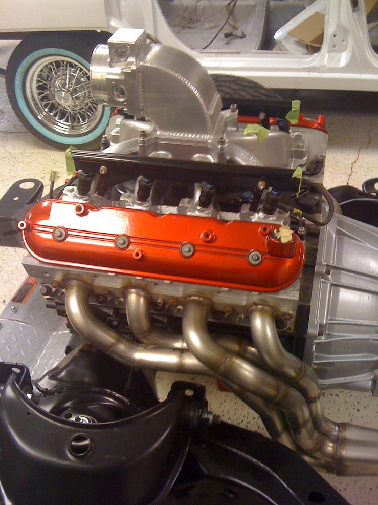

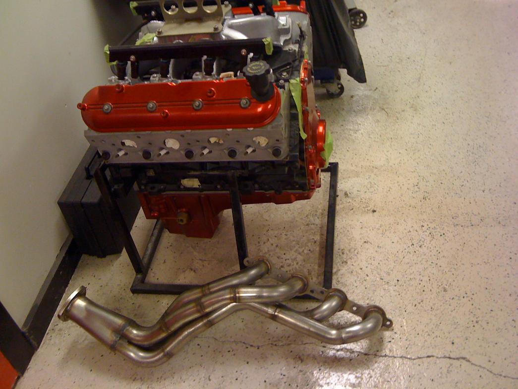

No it is some of yals flanges, tubing and grab bag bends. I dont think yal had a kit for this when i built these. I do think both kinds (Gen 1 and 3) would sell thou for these trucks. The headers yal make for the new model trucks are awesome and if yal did some those year models they would be too.

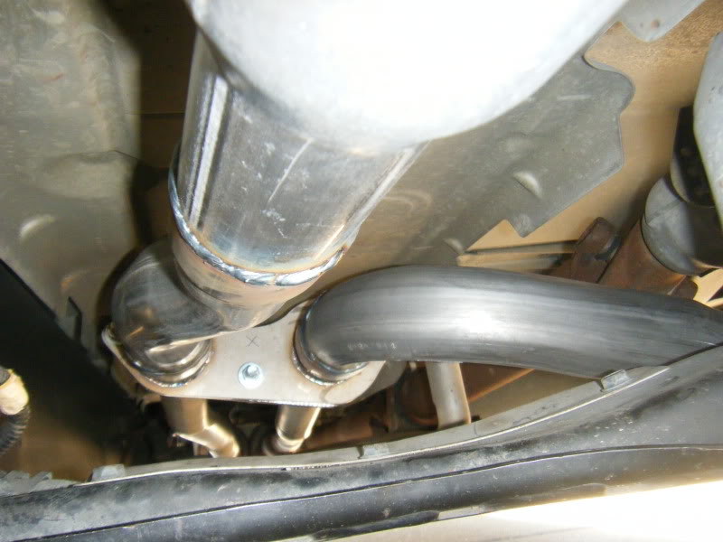

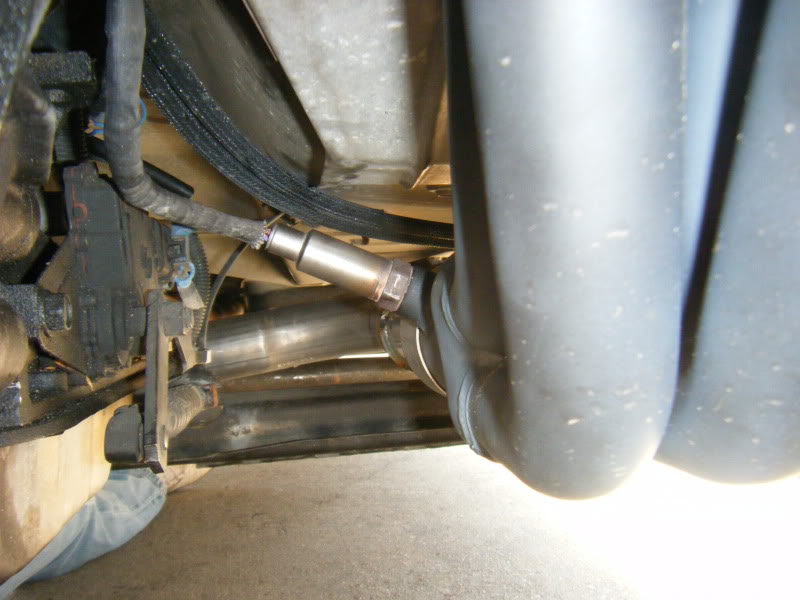

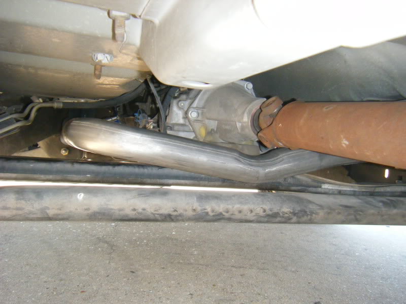

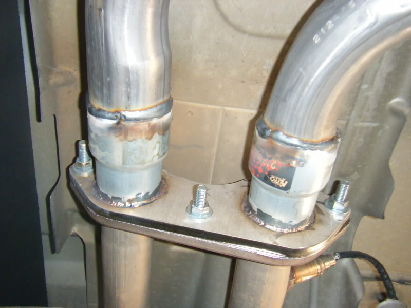

I also have the Pacesetter Longtubes for the 96-99 OBS 5.7L trucks. Here is how I did my setup. Started with a 3/8" laser cut flange so that I could connect it all back to by stock catback:
Then welded some reducers in and had the exhaust shop make the crossover and the rest of the Mid/Y pipe:
It all ended up looking like this:
As of now I've switched from the factory duals and made a Y that bolts up to the 3/8" flange and I'm running a Single in/out Magnaflow.
