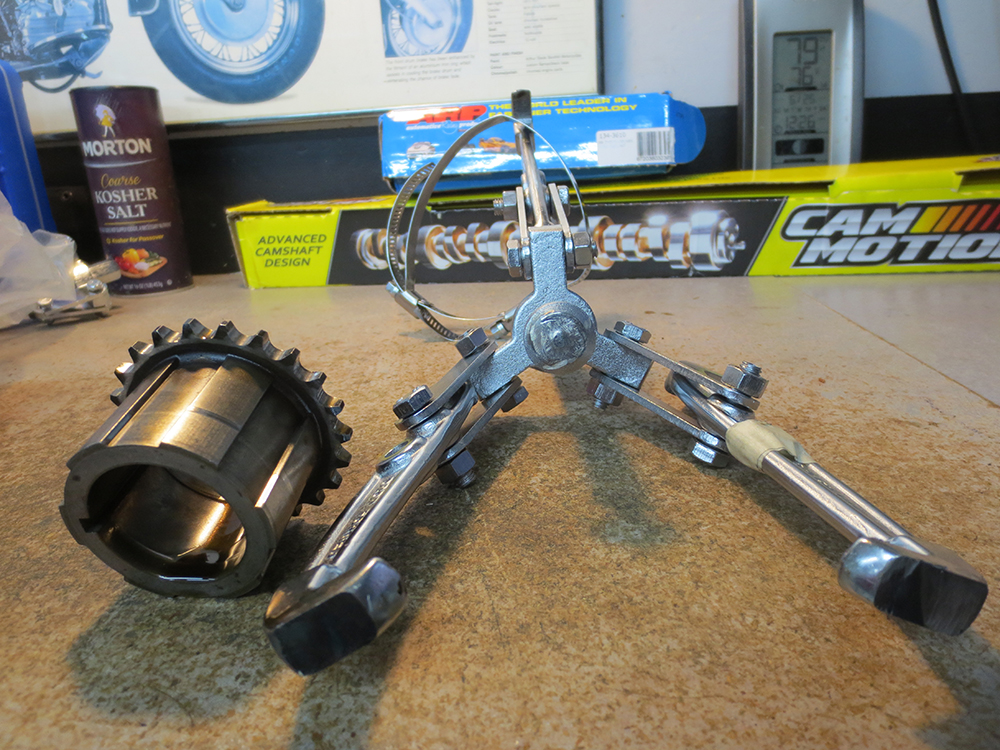

Since pulling the pan is no problem I can add some info...
You'll need a puller to get the crank gear off. I had the cheap 3 jaw puller set from Harbor Freight that comes in a set of three. Using the largest puller I had to grind down the claws so they would fit behind the crank gear. I also ground the point off of the pusher so it would hit the installed (for safety) crank bolt evenly. I used a large hose clamp to hold the arms from popping off. It took a couple of tries to get the gear off. It helps if you have extra hands to hold the puller in place.... I did not. During my research I found the OTC 1025 5 ton two jaw puller works with no modification. I gave the OTC recommendation to another member here and he said it worked great. Amazon has it for $45 Prime. I actually bought the OTC but while it was in transit... the modded HF popped off the gear so I returned the OTC unused.
OTC 1025 Puller OTC 1025 Puller
My modded Harbor Freight Puller with the claws and button ground flat (notice the 2 piggy backed clamps)

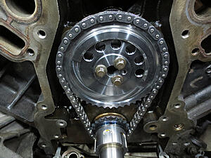

The new bottom gear from a quality aftermarket timing set will slip right on by hand. The installed balancer pushes against the pump drive to hold it in place. I used a Rollmaster Billet set (CS1180) that has the good IWIS chain.
