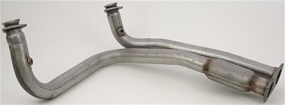

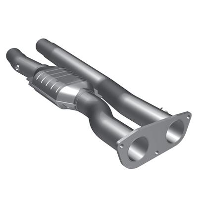

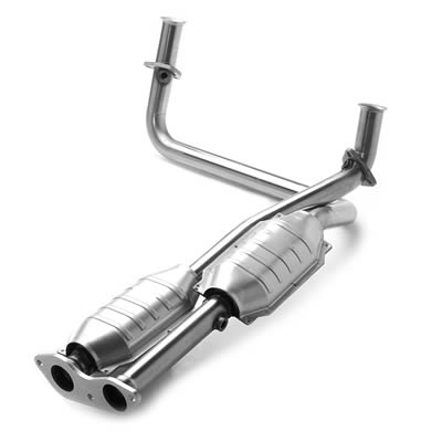

I answered your question at the other site, but here are some more pics of teh exhaust.
Here is teh Magnaflow direct fit, it has 2.5" pipe that is mandrel bent.
here is a Catco rear section for 3/4 ton apps
And its matching front section
Walker front
Walker rear
Magnaflow front
Magnaflow rear
Stock Vortec 350 1/2 ton and 3/4 Vortec 350 stock pipes
The 3/4 ton cats/exhaust is MUCh better.
All of the pictured exhausts, will bolt up to stock manifolds and shorty headers.
peace
Hog

Thank you for the help! I did see your response on the other site as well but was wondering what the "PE" mode is?
I like the idea of finding some of the 3/4 ton pipes at a junk yard I'll have to give that a try, but if not I will just be keeping it stock. One concern with that though it that I have a 2 door tahoe, so the muffler is in a different location?
Like I said I would like to do full exhaust/intake but it would get pretty spendy going with a fully stainless system and tune, I just had to replace the front hubs which wasn't cheap even doing it all myself. I get more enjoyment out of putting upgrades on my car, and would rather put that money towards a heads/cam swap. Plus the doors on my tahoe are rusting so I need to address that as well, other than that though the truck is in good shape.
My plan right now is to pick a set of used shorty headers, new gaskets (do you know the part number for GM MLS gaskets?) and run it. Maybe get a BB or PCM4Less tune down the road. I don't expect to gain much or even notice a difference but for $125 it can't hurt.
