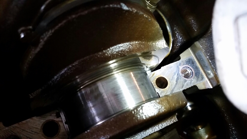

This is towards the rear of the engine side of thrust bearing

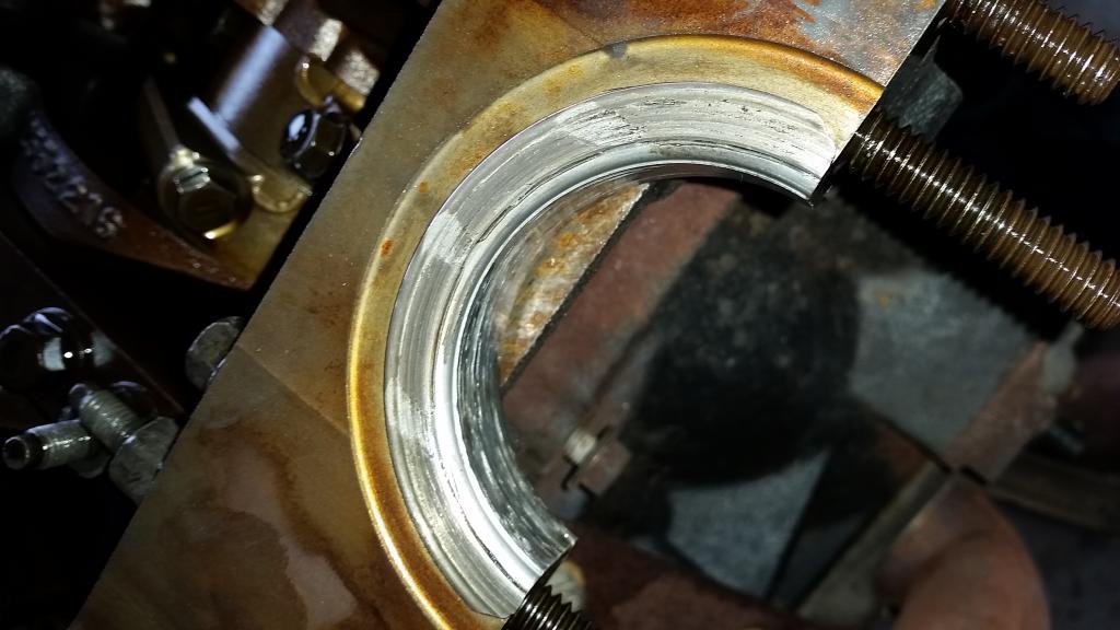

This is the better side of the bearing which appears at least within a thousandth of factory spec according to clevite

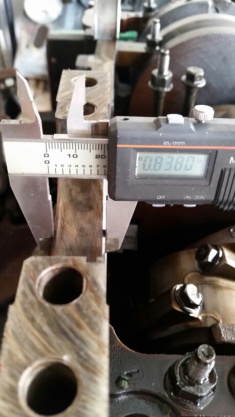

I do believe this is the measurement you were in search of 1fastbrick? (.838)

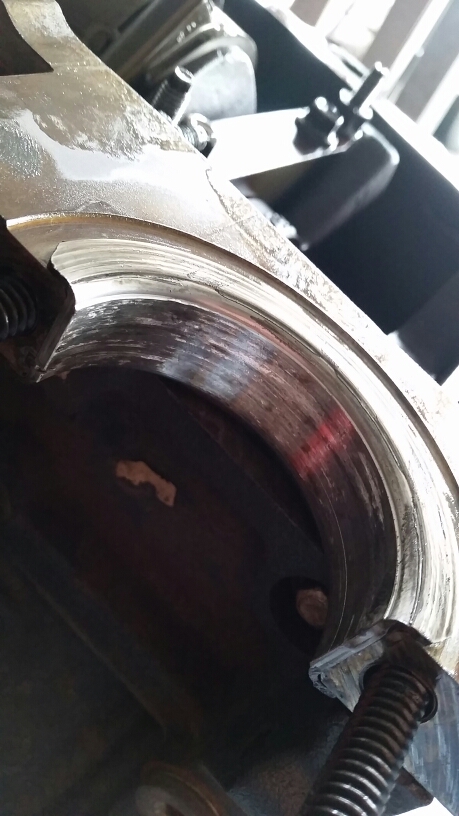

good side of thrust flange, crank side, forward side of thrust bearing

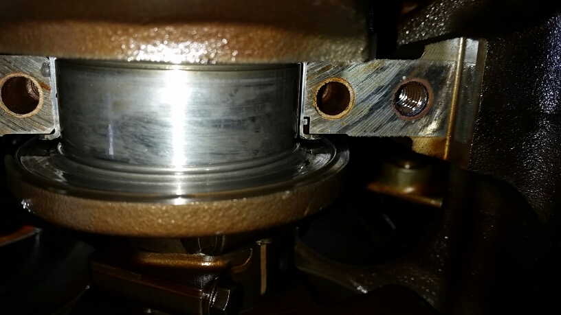

Hard to tell but there is a deep ridge where the thrust bearing rode, cant say for sure whether my new bearing ate it or if it was already eaten some how prior to my assembly. (rear side of thrust flange)

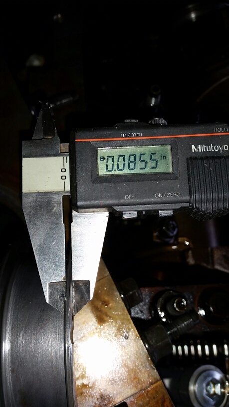

Rear side of thrust bearing (facing flexplate)

all in all I believe I need a crank and mains, then I will double check my tolerances and probably jam it back in the truck and hope for the best. Budget isnt allowing for a build, prefer not to go 6.0 route, if I did a build I want a low compression 383 for turbo later on.

The measurement I referenced was for the Crank itself. It's measured between the 2 thrust surfaces.
From the pictures you posted, That crank is now a large paperweight.

It can be welded but for the cost of doing so it would be easier to just get another crank.
