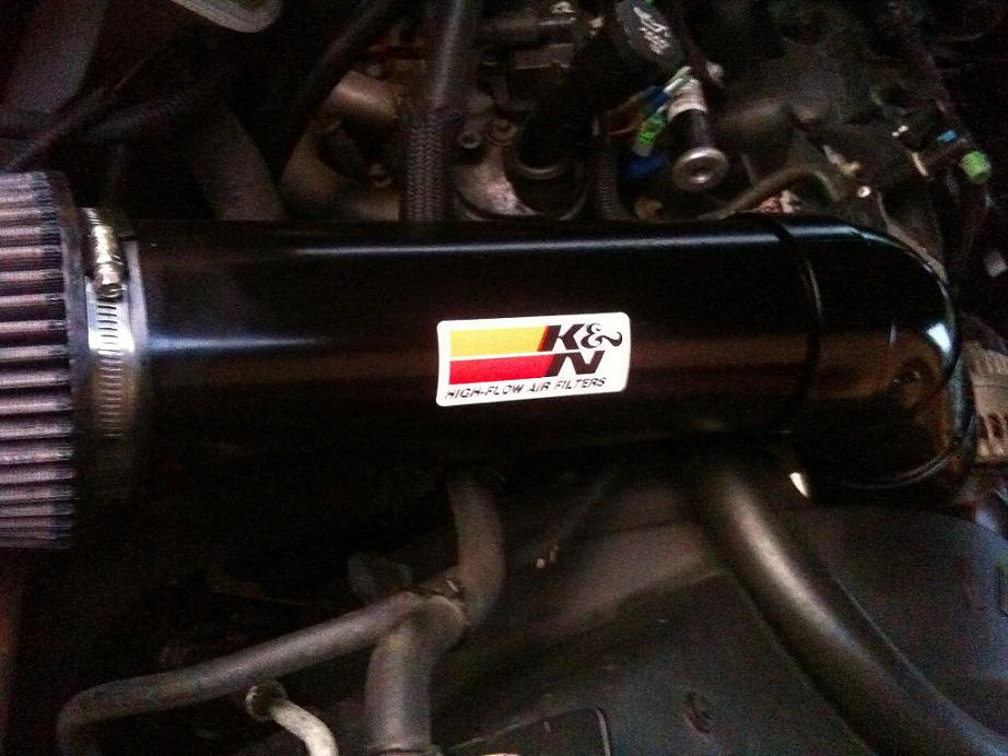

I have been running my homemade air intake that I have made actually out of just 4" drain/sewer pipe for about 2 months now but I may still use something different but I am happy with the function of it. I actually ran the tubing and filter outside of the engine bay down behind the front bumper where it's always scooping up nice fresh air.

No problem man. Here is a quick pic I took when I was just starting to mock it up on the truck and just had the filter still under the hood but I think the tubing looks like a pretty clean install.
