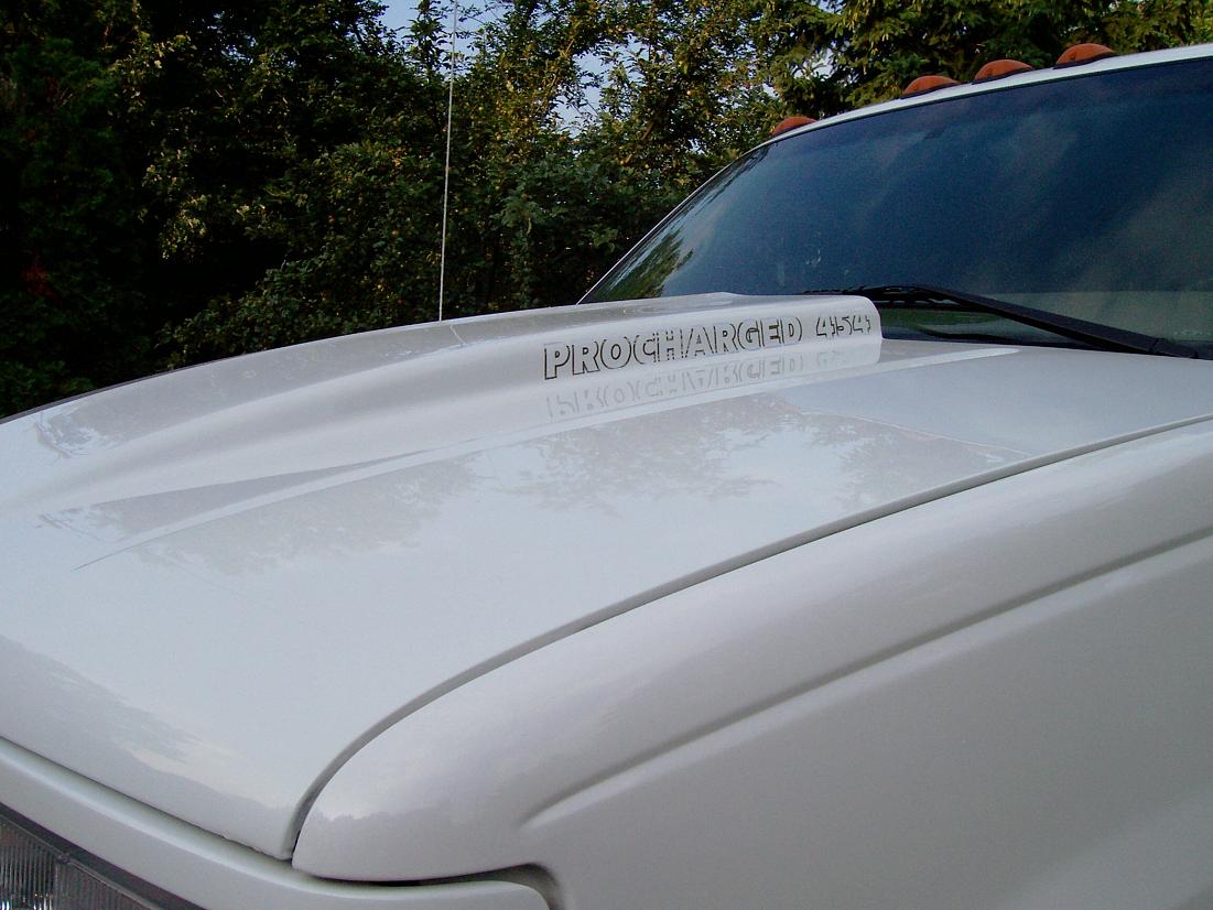

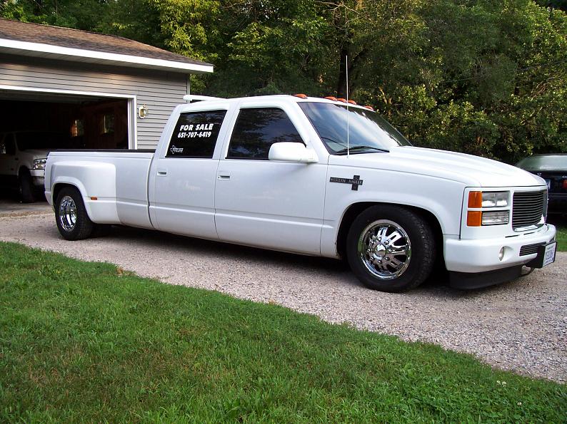

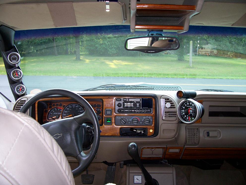

This one made some ***, stock heads, unopened longblock, boost profiled cam, headers and a tune.....D1SC @ 16psi, 83lb injectors, methanol and a good sized intercooler. Beat it sencelessly for 48,000 miles before I sold it..
1997 C3500 Dually Crew Longbox with a 5-Speed. Ill dig up the dyno sheets and post them.
Id skip the overdose of spray.....That old addage...If your gonna spray your gonna pay goes far....
Just my opinion.
