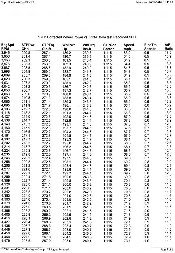

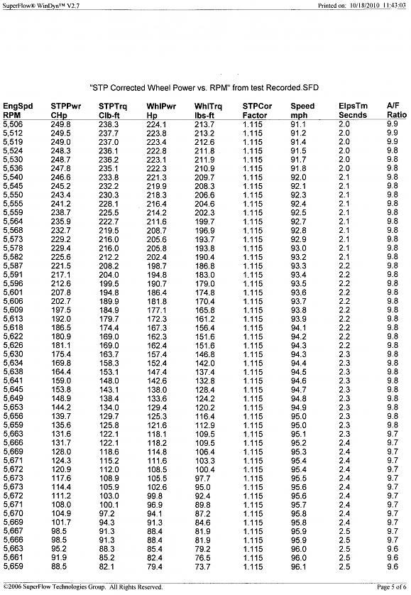

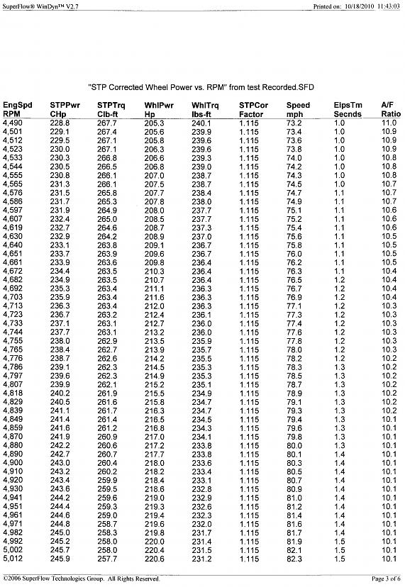

here is some more sheets about the rpm and what it all seen. i believe this is what the stock map produced thru out the rpm range.
Attached Thumbnails 2010 chev 6.2 WOULD NOT MAKE POWER ON THE DYNO?!? WTF!?-page1.jpg   2010 chev 6.2 WOULD NOT MAKE POWER ON THE DYNO?!? WTF!?-page2.jpg   2010 chev 6.2 WOULD NOT MAKE POWER ON THE DYNO?!? WTF!?-page3.jpg   2010 chev 6.2 WOULD NOT MAKE POWER ON THE DYNO?!? WTF!?-page4.jpg   2010 chev 6.2 WOULD NOT MAKE POWER ON THE DYNO?!? WTF!?-page5.jpg

Originally Posted by Vegas Panton
I had my 2010 6.2 Sierra 1500 4X4 dyno tuned by a very experienced tuner on a Dyno Jet. The peak RWHP went from 288 to 290. I thought I should see more, but it was not to be. He did flat line the A/F ratio at 12.7 and reduce the TM by 30%. The mid range numbers did improve. Did it make a SOP difference? Yep. I guess that transfer case and heavier wheels and tires on the 4X4's take some additional power. Maybe with some shorty headers and a good CAI, I could get over the 300 mark. Pretty happy with the way it drives right now.
yeah thats all i seemed to get from the chart was 1 hp. but the power seems to come on way way earlier now and fuel mileage was better also after.
i think im going to try Volant cai with the donaldson filter instead of the oil type filters. the donaldson isnt going to probably flow as much as a cotton filter but it aint going to get the dust get by like the others will either. i will leave the stock muffler for now but that little resonator unit is coming out. a little too quiet for me yet. i like a little rumble.
i would like to go to a supercharger but there isnt no way im going to get that by the wife...:nunchuk1:
