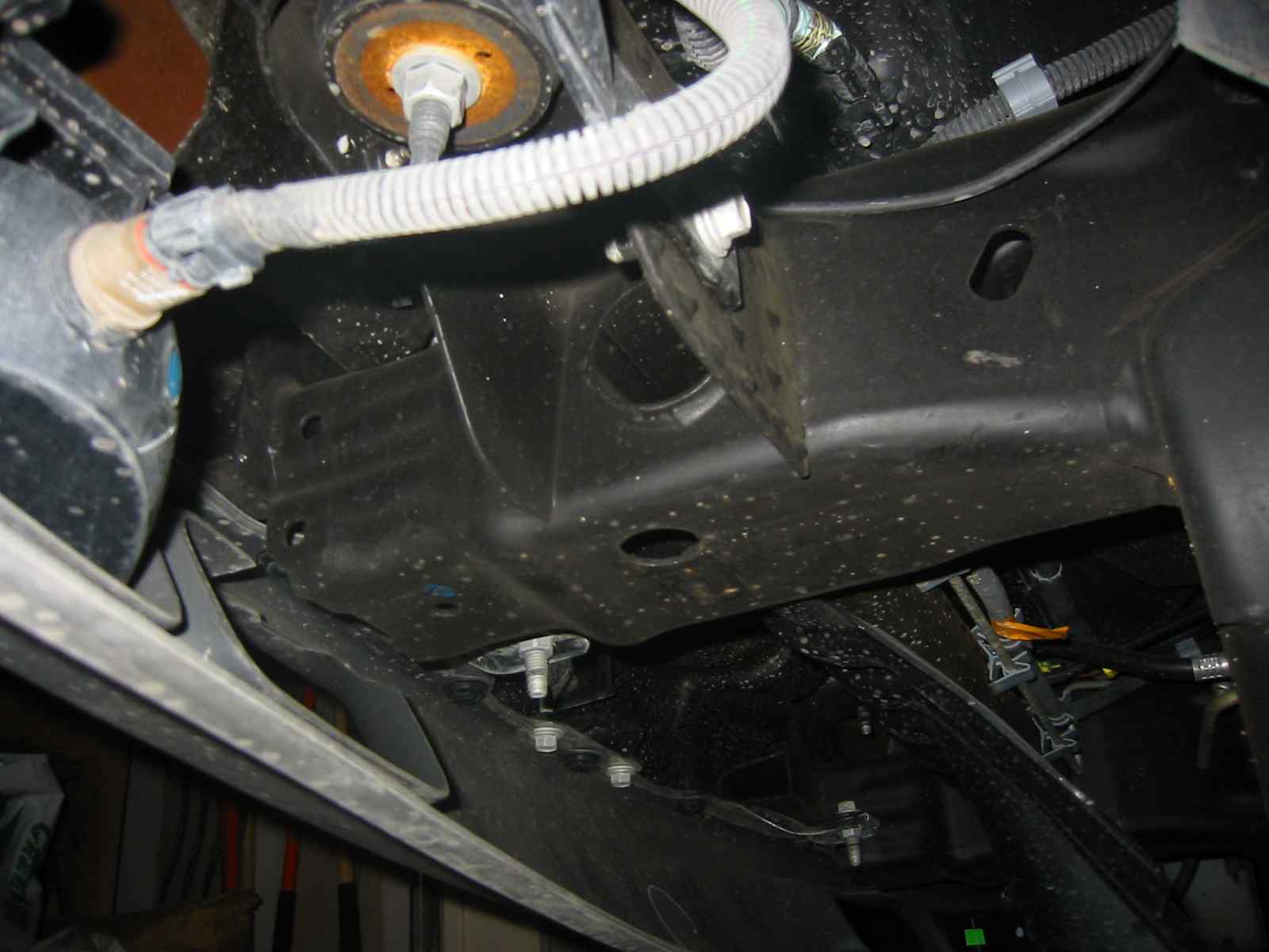

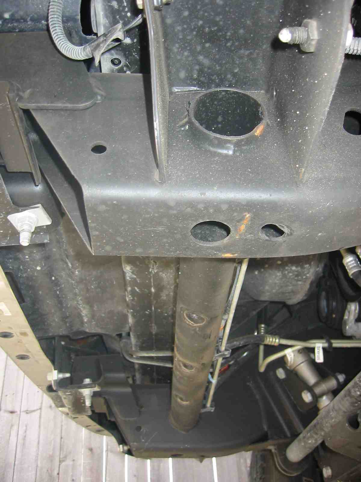

Does anyone know if GM changed the 1500 (HD if it matters) frame in 2003? I started the install of a ProCharger intercooler, and found that the supplied brackets don’t work. The front brackets are made to bolt to a hole near the front edge of the frame, where the tow hooks are attached. The installation pictures show a frame style where the end is cut off at a straight 90 degree angle… mine is cut at an angle, and the area where the needed hole would be is missing.
I am trying to figure my 2003 is different because it is a “HD” model, or if all 1500’s are this way. My understanding was that the 1500HD uses the exact same frame as all the other ½-ton pickups.
I will attach some pics…
Brian

I took a picture of a 2004 tahoe. It has the same frame as shown in the ProCharger instructions, note the smaller hole close to the front, with the blue dot next to it.... this is the hole needed for the intecooler bracket.
The 2003 1500HD is a little different... and is missing the hole.
Attached Thumbnails 2003 1500 frame change from previous year?-2004_tahoe.jpg   2003 1500 frame change from previous year?-2003_1500hd2.jpg
