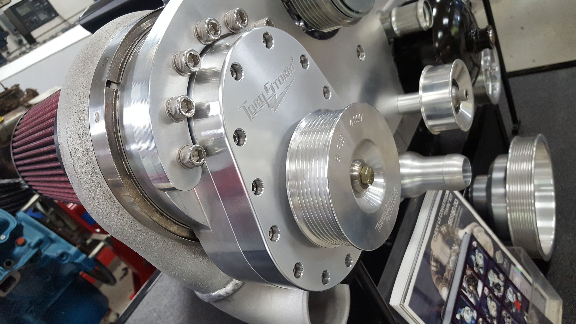

Check out or Superchargers.
TorqStorm Superchargers
Should be finished with new new design for the 99-06 real soon. Approx $2800, lifetime warranty.
your site says 3500, price coming down?
yes i do believe so
