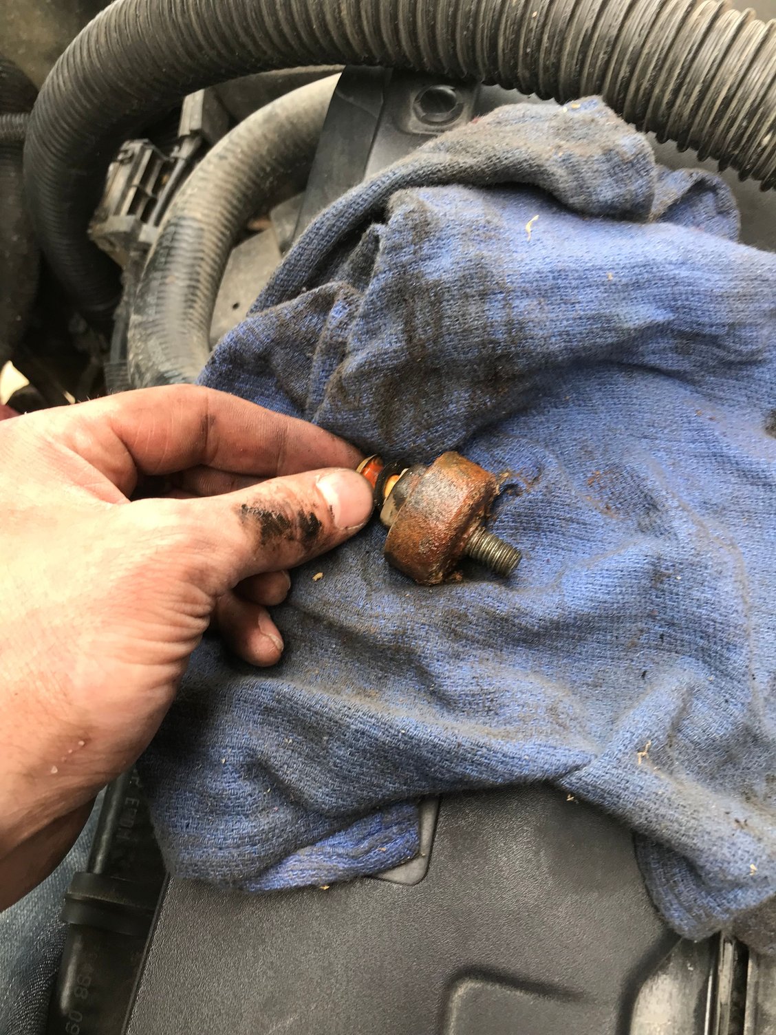

The po332 I just fixed on mine-
Were you having detonation prior to replacing the Knock Sensors?
Old 06-05-2018, 07:46 AM
13 Second Truck Club
trxmxzx's Avatar
Join Date: Nov 2006
Location: Hartland, MI
Posts: 874
Received 13 Likes on 12 Posts
Misfire detection, pulling 7 degrees of timing under a load
no ping though
