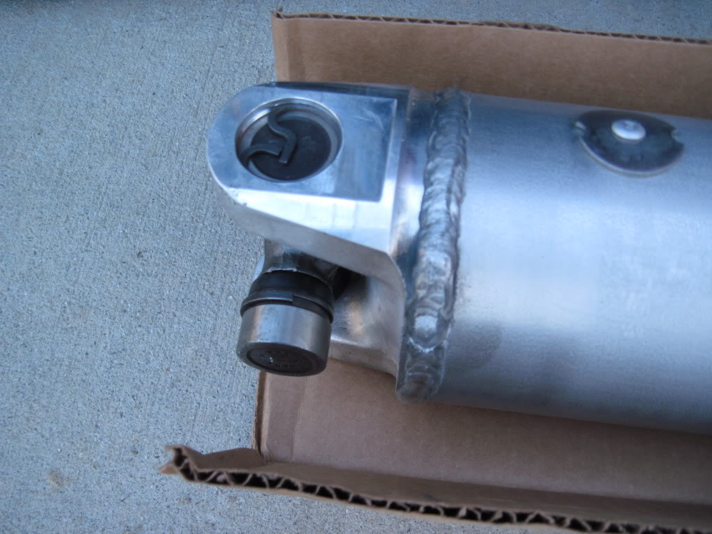

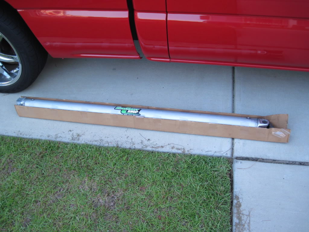

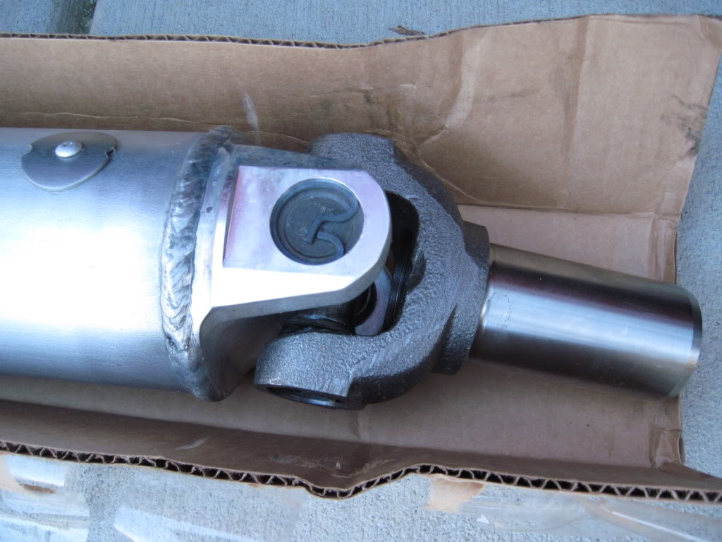

Both my U-joints were still in place on the truck when my factory one piece let go. I even had it re-balanced a few weeks prior because I knew it would see some speed.
Any case, I can recommend DriveShaftShop to others. They made a new one and could tell me it was safe to 170 before critical shaft speed would come into play. Wish I still had it, but it was built for my 5speed. Now I got a locals shop steel shaft that just broke a u-joint on it. I'll be honest, i don't trust it near as much.
Here's the old DSS piece, I want to say it was like 525 shipped.
