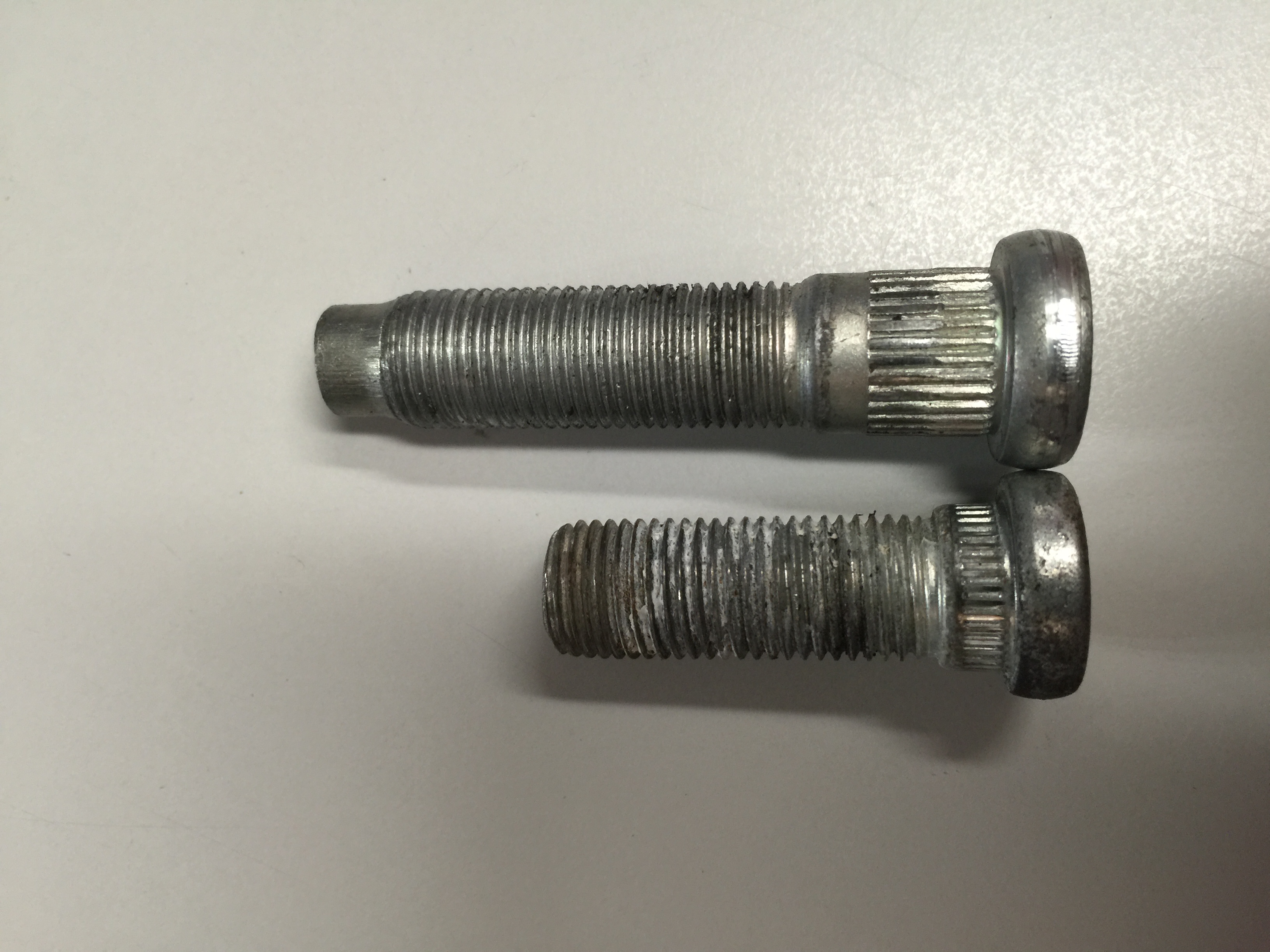

I swapped to a 9/16 stud because no one makes a 14mm stud that's longer than OEM
Old Jan 20, 2016 | 09:32 PM
iamkeniff's Avatar
Posts: 5,365
From: Gonzales, la
Longest 14mm on the bottom vs the 9/16-18 on the top
Attached Thumbnails Wheel/caliper clearance with spacer?-image.jpeg
