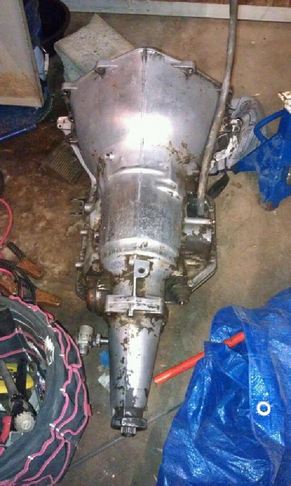

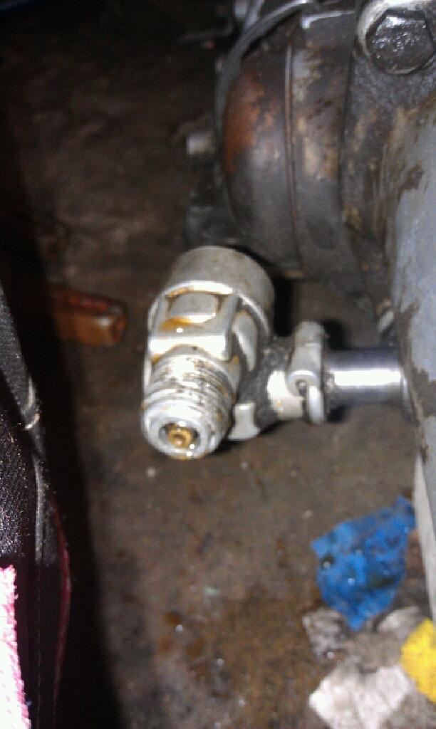

found this transmission.. says its turbo 350 with an overdrive... have never seen an overdrive unit like this one.. guy doesnt know much about it.. ive looked to see if its a 700r4, but havent seen one like it, the tailshaft has a wierd deal protruding out of it, what is this, ive never actually inspected one up close, he says ther is gears in the tailshaft

woops sorry thought they posted
just wanted to add i have never messed with trannys i have no idea about whats what never taken one apart soo.. any help is appreciated

looks like a van th350 longtail , no od there might be a lockup converter though

The component in the tail housing is for the speedo. The trans is a 9" TH350.
