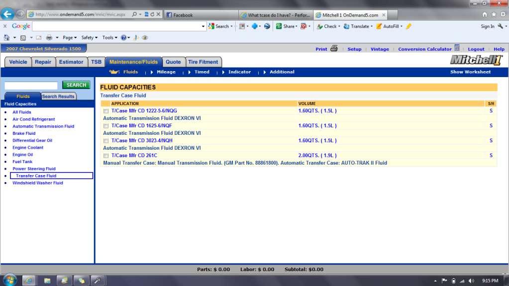

Looks like Dex 6 or Auto-Trak II. Check your N codes on the RPO sticker.

NQH is what I've got. Wonder what the difference between my tcase and the normal autotrac tcase is...

NQH uses Dex 6, not Auto-Trak II.
