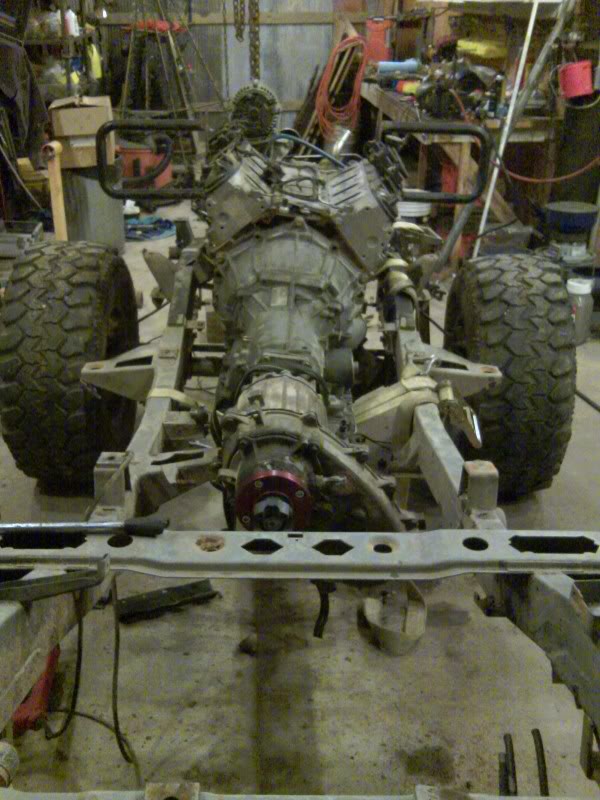

The NP241 out of a 91ish 4x4 suburban is what you need.. its a passenger side drop..
I used one in my Samurai for Toyota axles..
