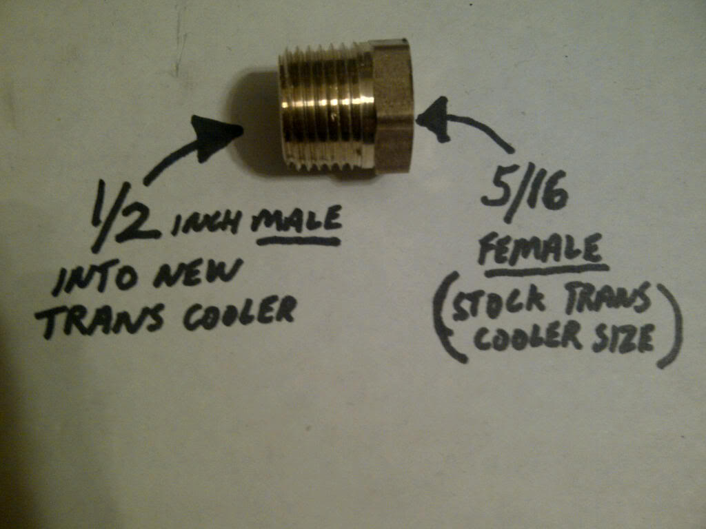

So I have been all over the place looking for this adapter fitting for my trans cooler set-up....this adapter is the SHAPE that I need but isn't the right size.....
Does anyone know of or can anyone find a part number for a fitting that is the sizes I labeled in the picture?That would help me out a LOT! THANKS!

Which trans cooler are you installing? Also, are you trying to use the stock trans cooler lines?

Being the picture you posted looks like a NPT thread design with the taper. Im gonna asume you need a 1/2"npt to 5/16npt reducer bushing?

it's a B&M hi-tech cooler with a fan....I have everything set up and mounted....just trying to use the stock line fittings and screw them into an adapter to 1/2 inch......
I'm starting to think that automotive uses 5/16 and not much else.......LOL....went to every hardware store i could think of....was thinking about calling up EAR fittings to see if they make something like that.....
yes....the threads are all even down the stock fitting with a gasket at the end (not compression right?) and aren't compression type on the cooler.....
