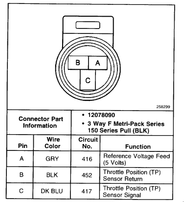

I am going to replace the TPS sometime this week hoping it fixes the problem.. I disconnected the battery for 10 mins and it made no difference. I don't have access to a data logger either which kinda sucks and I could find how to check if the TPS is working smoothly

Well, if you have a voltmeter, check the voltage from the 'Signal Return' wire. Of course, find a good ground for your negative (black) probe. At WOT, that voltage should be above 4VDC (Note the ref voltage is only 5VDC). At 0% (closed position), the voltage should be under 1VDC. Depending on your voltmeter, you may or may not be able to probe the backside of the connector to make contact with the pins. I've seen instrument techs improvise in similar situations.
I'm no ASE-certified mechanic, but I would start there if I were suspicious of the TPS being at fault. (see attachment)
