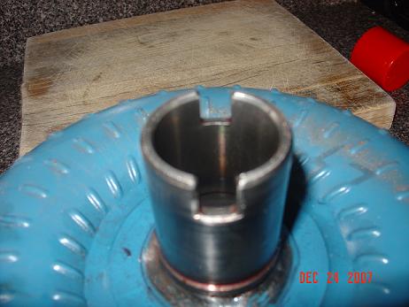

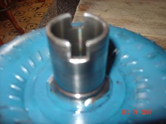

hey vince took some pics of the stall, yeah theres very little damage on the hub .. is there a way i can fix this maybe some simple filing to straighten the edges ... or even weld the cut outs up machine themand recut them or cut them a cross from each other, mind you i am a mechanical planner ( X machinist) with machine shop access)
heres some pics

really think it would be ok, as long as it seats in the pump locks all the way ... watcha think, but then again i really dont wanna take chances

It is hard for me to see the damage from the pictures that you have posted. It might be a good idea to have your builder take a peek at it and see what he thinks. I prefer to have a new hub installed. Seeing as the builder has to warranty the unit have him take a look and go from there. Vince

actually there isnt any damage to the hub of the stall, except the corners are alittle rounded.. but anyway i will talk to my biulder and see what he sugguests after he fixes the tranny on warranty
