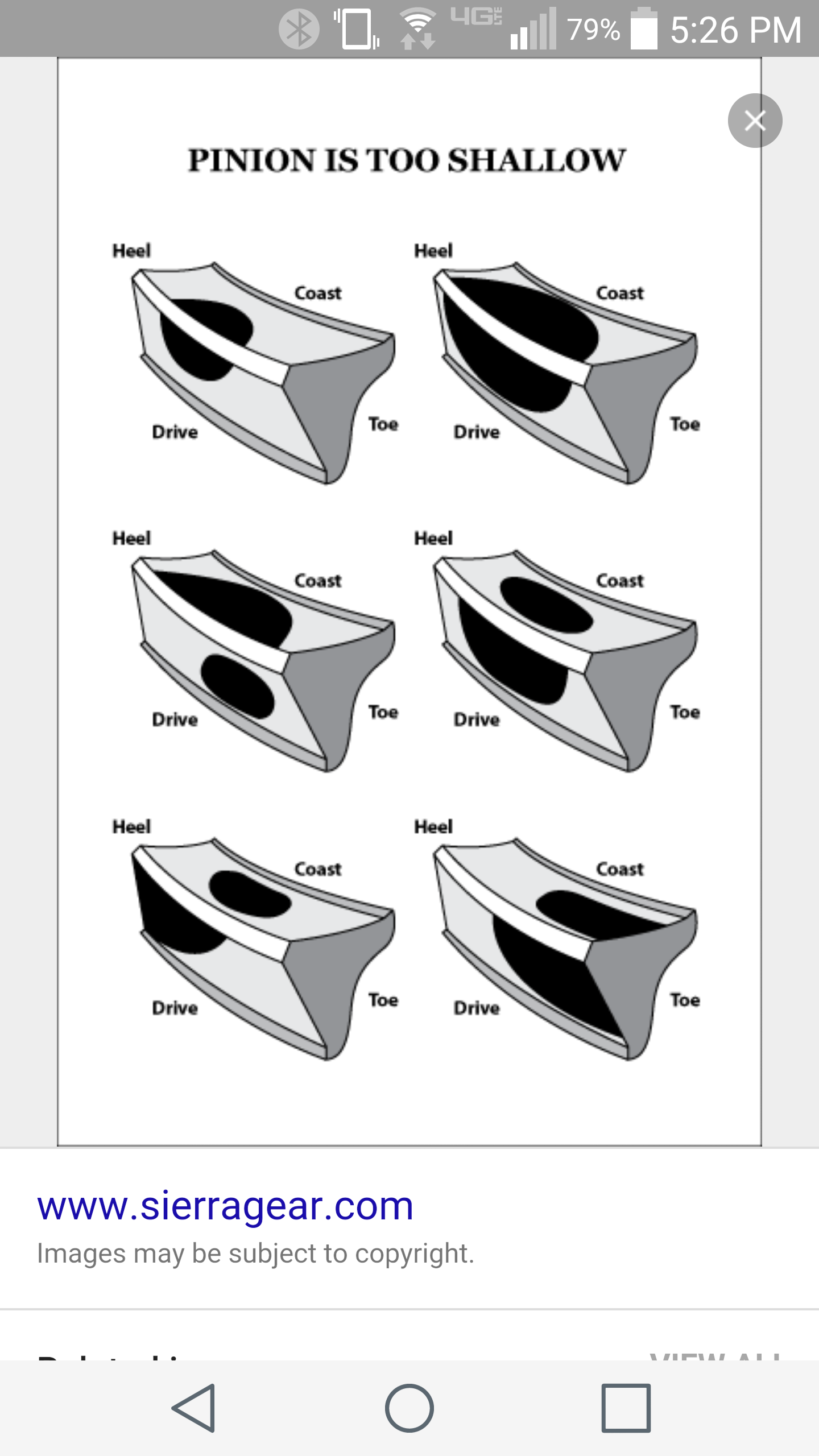

Take a look at my gear pattern.

Originally Posted by George C....
To me seems as pinion is to shallow and once it starting breaking it it started making noise since pattern is becoming further out....will continue to make whine how its setup
wouldn't the pinion be too deep if it's wearing on the inside? or are we just using deep and shallow in exact opposite terms? when I say too deep, I mean the pinion is shimmed too deep into the case.

Attached Thumbnails Take a look at my gear pattern.-screenshot_2016-02-06-17-26-17.png

Well I called the installer and he was pretty rude today saying how they are just a loud gears and I'm fretting over nothing and he may be able to look at it Wednesday.. Sooo, I bolted the radials up, filled a bottle and am going to make some hits to see if it gets worse.
He did manage to tell me depth is .035 and he set back lash "tight" at .006
But these were his words. I don't know if he's telling the truth or not.
I'm almost wondering if it's in the tru trac since he put synthetic oil in it with these helical gears causing a whine.

I dont go off numbers, ive always went off pattern and feel
My gears i setup never howl and have held up in all my builds
I know ppl who go by numbers, howl and tear up teeth

This happened to me with my old silver truck when I first installed my gears. I went back to the installer 3 different times with two sets of gears. He couldn't get it to not whine to save his life, kept saying it was the gears.
I took it to a drivetrain specialist here in Austin recommended to me a by friend. They were professionals and had it done right.
Like George said, if it's making any noise, it's not installed correctly. Don't let that dude bust your ***** about it being the gears. It's usually not the case.
