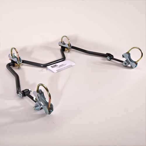

Calmax Anti-Sway Bars - Items - DJM Factory Store
These are the ones I was planning on going with.
What's better about the Hotchkis bars?
I really like how the rear mount is designed.
If I were to guess, I'd bet that the DJM bar will have the same effect on the vehicle's body roll as the Hotchkis bars that I ordered. I didn't find what size the bar is that you posted, but it's listed as being "tubular", which to me means "hollow", just like the Hotckis, it just appears that it mounts differently than the Hotchkis. It mounts the end links to the cross bar under the bed toward the rear of the truck, which is the same design as the Addco and Hellwig bars that a lot of guys run, and report good results with. I needed a bar that mounted forward as my tailpipe is in the way where the rear mounting bars attach, and I don't want to move the exhaust around (I just put the exhaust together a few months ago and like it the way it is). I've found that the Hotchkis and Belltech both have forward mounting rear bars, and my previous posts tell the tale of how I ended up ordering the Hotchkis kit
*EDIT* After looking deeper into your link, the rear bar that you're considering is a 1", just like the Hotchkis, and is about $245...it's your call man. That price is about the same as my rear bar so you could ask around and see what some folks have to say...I've heard good things about the Hotchkis stuff (a bunch in this thread alone), but I'm not sure who's running the DJM stuff and their feelings about them. I've heard good reviews about their control arms, and if I were to guess I'd *think* that their sway bars work well, but have no hard evidence to back up that guess.
Hopefully someone who's had some experience with the DJM stuff will find this thread and post up their impressions...I like to get as much info that we can obtain and share as possible

Originally Posted by Jeff_383
Does anyone know if the DJM bar clears stock a tailpipe and spare tire location?
From the pic that you posted, it *looks* like it does, but I'm not sure. Actually, in that pic, it looks to me like that bar needs some shorter end links as that truck is lowered a bunch...shouldn't the bar be fairly parallel to the frame? (looks more like it's parallel to the ground)
The DJM bar, Addco, and Hellwig are all secured to the truck the same way, and I'm pretty sure that guys run the Addco with their spares and stock tail pipes fwiw...
