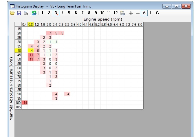

TUNE!!! I just put a Pheonix 2,600 in the 4L80E in my Express van. Stalls 2,750 behind my 350. My setup started running so lean it was bogging and even popped back into the intake when I jumped on it from idle. Fixed the tune and it runs MUCH better than before. They were all slightly negative before the converter.
