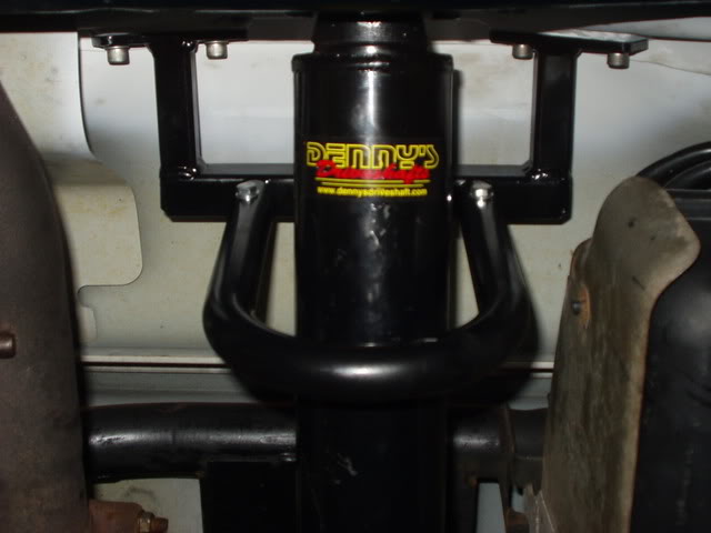

Here's what I did. I made the loop from one I got from Summit, but fabbed a square tube frame. The mounting brackets are 1/4" plate, with tapped holes, welded to a heavy spot under the seats ( I think in the seat belt boss). The square tube frame has a corresponding mounting bracket.
I thought about coming off the crossmember, but just couldn't come up with anything I liked.( I'm kinda picky that way!)

I thought about making more, but I think the different body styles won't have the same spacing for the mounting boss vs the required 6"to 8" location from the forward u-joint.
