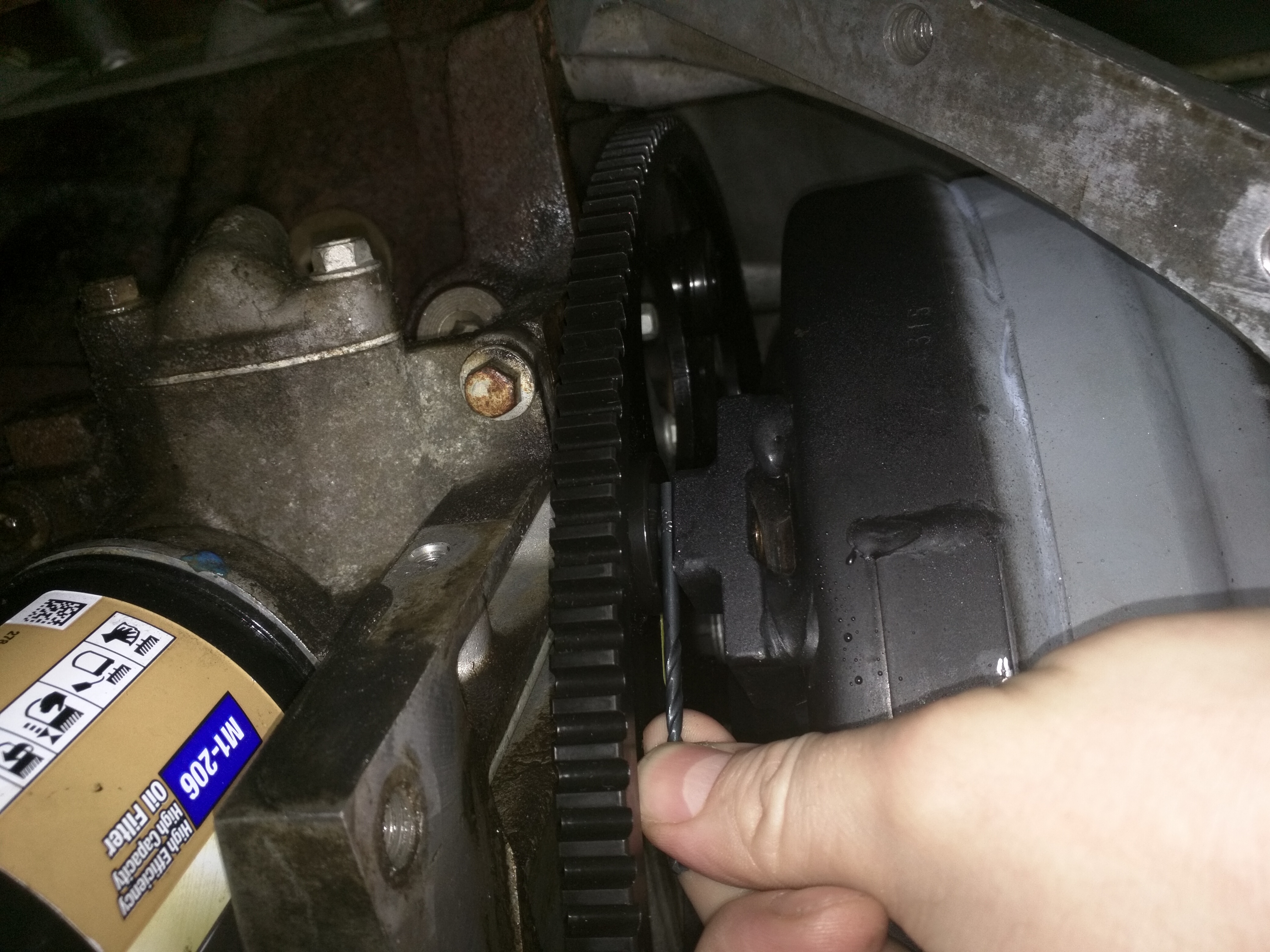

I used a 1/8 inch drill bit to measure my spacing.

Quote:
Originally Posted by
X_Racing1
and what should it be 1/8 inch then?
Yeah, from torque converter bolt holes to flexplate. A little more or little less is OK from what I've read. I am not a pro though.

Because for some reason I take pics of everything.
lol

I agree with these guys, check it to make sure.
tgui - nice pic!!!
