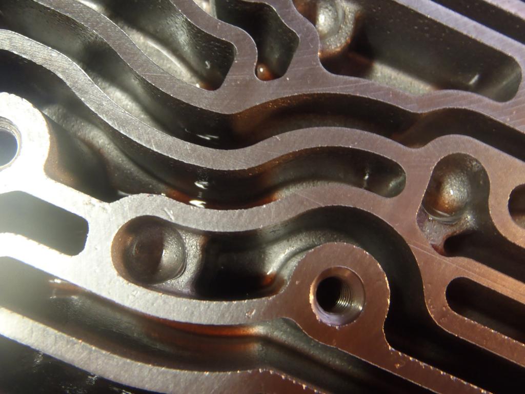

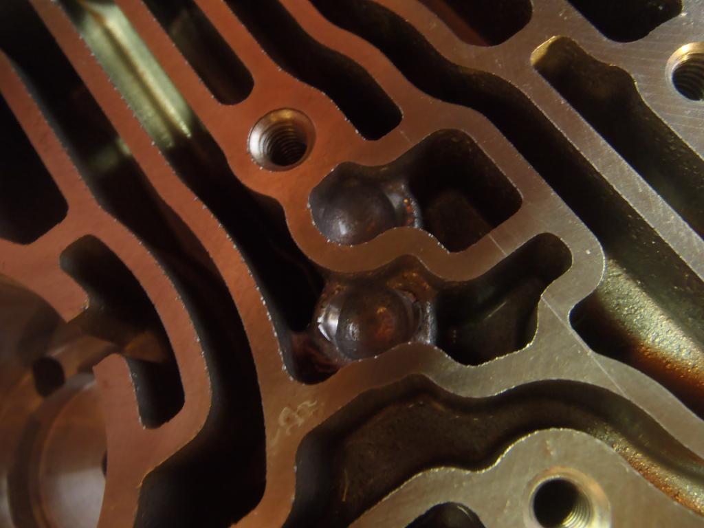

Well I pulled it all apart today. I got at far as I could without using special tools. The clutch packs all look really nice, but since it's apart I might as well replace them with better ones. All the gears looked good too. No obvious damage except for a couple things that concern me.
The little ***** in the valve body seem to have moved around a lot and mashed the aluminum of the casing. Only 4-5 of them show this going on, two of them were pretty bad. A similar thing was going on on the valve body itself, but not as bad. Is this something to be concerned about?
