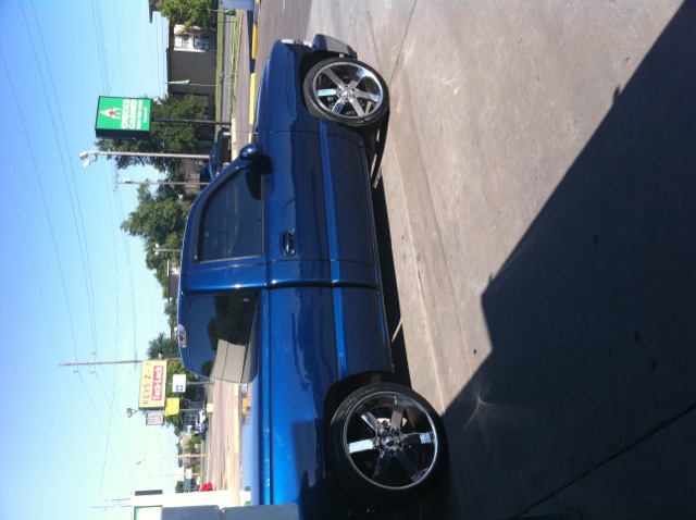

ok so i had 2 inch shackles in the back...this past weekend idk wat i was thinking and i had them heat the springs and in the back they fliped the last leaf spring.....it looks awsome but i HATE driving now bcuz its way to rough!
so please i need advice on wat to buy to juz make it ride smoother...and do i need to mess with the rear...i dnt wanna buy the whole kit juz parts to make it ride smooth...plz help....and i have 22s on it should i put the stockers back on?

buy a set of new springs or lowering springs. flip back your leaf spring (wtf?)

thats what i was thinking lol.....to start off with, how low are you wanting to go??

unflip that rear spring and install a set of hangers, that should get you a four inch drop with the shackles in the rear. in the front i would pick up a set of 2" lowering springs and add a set of belltech street and performance shocks all the way around.

Heating the springs is old school. Take the advice given so far.

Flip the last leaf spring(would this be the overload spring)? Heating the springs= destroyed springs. You are probably riding on the bump stocks or really close to it. If you have them flip the spring and order 2"drop springs or spindles, your ride quality will go back to stock. And like BLK WDO says "cheap work isn't good and good work isn't cheap" My .02

Ok wat if I buy new springs n cut them the proper way with out heating.and buy sum shocks...will this help.? It's wat am leanin towards

Why would you buy new springs and cut them? Do you mean buy factory springs and cut them? Why not buy drop springs specific to your vehicle and let them settle in? Drop shocks are pretty much a must when you change a vehicle's ride height.

Yea I meant factory springs...n ok shocks for the back to ?

Yes... search the threads there was just a recent post on how to cut coils. Even had pictures. Good luck!
