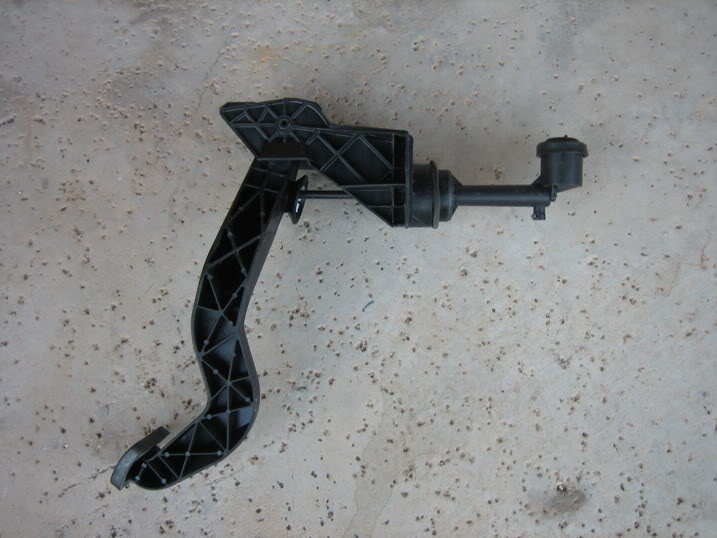

The first obvious thing your A4 truck doesn’t have is an extra pedal. To add one, you can order the assembly from a stealership or go the junk yard route. I went the junk yard route and found a complete assembly from a 2004 with 11 miles on it. The good thing about the pedal assembly is that the master cylinder is a part of it. When you buy the pedal assembly, ask for the master cylinder too. Attachment 138458

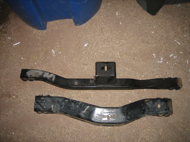

Cross member
I’ve been told that a factory 5 spd cross member will bolt in and work with the T-56. I wasn’t so lucky to experience this, as I have a 2000. Evidently in 2000 GM revised cross member designs, and I have the older style. The picture below shows the difference.
Attachment 138459

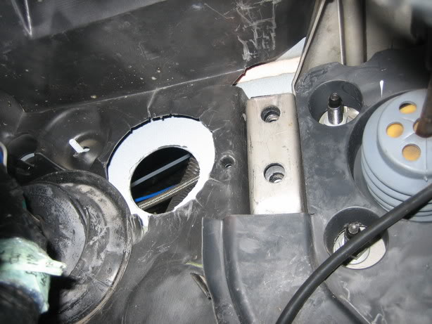

1. Locate the precut rubber/insulation under the dash on the firewall. This is precut, so it can easily be removed in a nice circle simply by pulling on it and tearing it out. You should now be able to see/feel a nipple on the actual firewall.
Attachment 138460
2. The nipple from the previous step is a dimple when viewed from the engine compartment. It is there so you can center your drill bit/hole saw. A 2.5” hole needs to be drilled and centered on this dimple. The dimple may be hard to see due to dirt, but just feel around for it.
http://i6.photobucket.com/albums/y23...8/1e89e57d.jpg

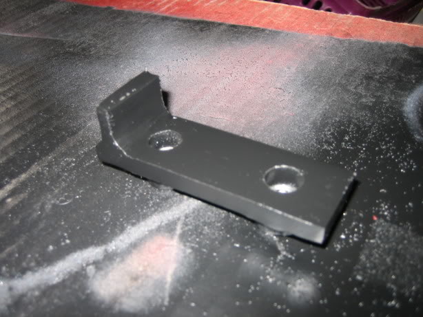

3. Under the dash, directly to the right of the hole you just drilled are two vertical holes (see above picture). This is where the pedal assembly mounts. I was disappointed to find that there was nothing to thread a bolt into in these holes, so I fab’d up a nut plate as shown. Attachment 138461
I felt this would be far easier than running a bolt all the way through the firewall only to have it wind up behind the power brake booster. I advise not to use large sheet metal or lag screws either. These will pull out over time, especially with severe power shifting.

Crossmember
If you have a late 2000-up, you’re in luck, because a factory 5 spd crossmember will bolt right in and work. I have an early 2000, so I had to modify mine. Here’s the difference between mine and the factory 5spd:
Attachment 138463
I just cut the factory mount off and welded on a piece of 1” square tubing as shown.
Attachment 138464

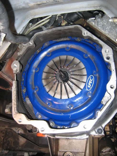

If you're making over 400rwhp/rwtq then I advise not to cheap out on a clutch. Get a dual disc setup or at least a Textralia OZ700. I learned the hard way that a SPEC stage 3 just won't survive daily driving conditions.

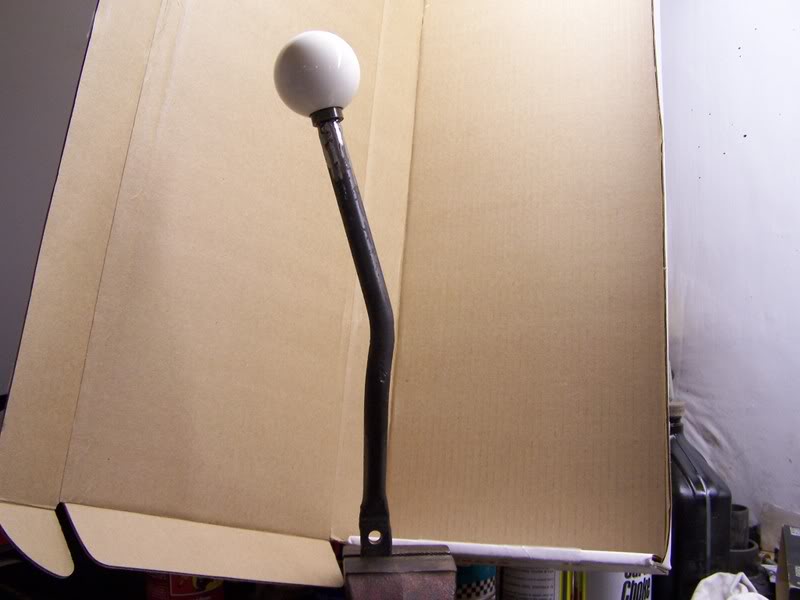

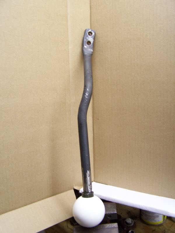

Pics of my shifter for console install. 5/8" rod total of 16" long before bending.

ok good question now is that the rod youre using with a 03 and up console or is that the rod youre using for no full console and just the jump seat style console
