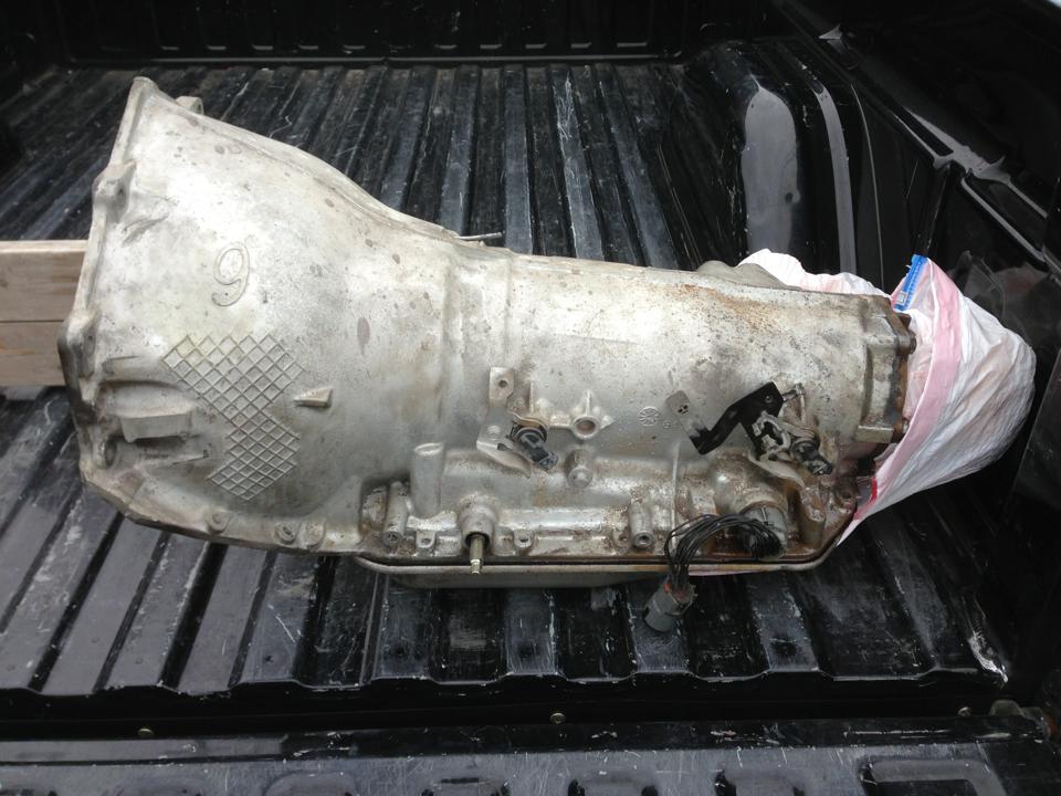

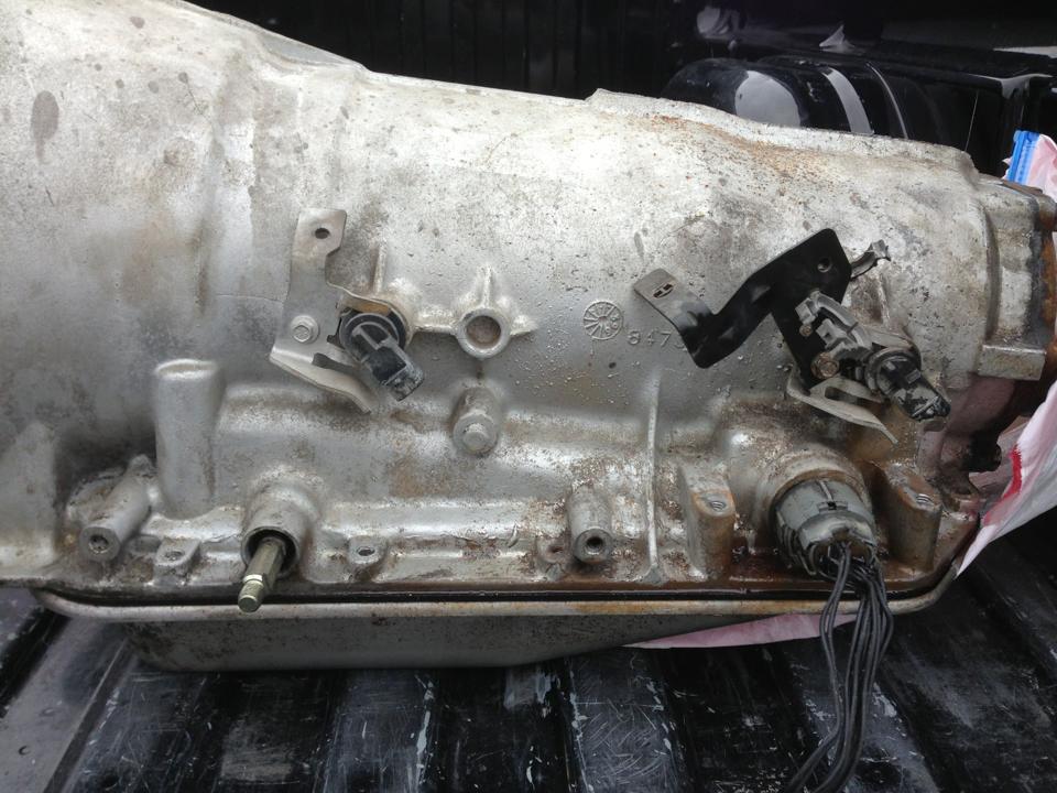

I know this one is an older one because it doesn't have the top bolt hole but will you guys look at this and please tell me if it will work with no problems

I believe that is a 97 or newer, it will be fine.

I sure hope you're right because I told my buddy to go ahead and pick it up for me. I was assured it was behind an ls1 in a silverado and it came with the plug to make it work with a 4l60e. I guess time will tell now.

Yep, cooler line locations tell us it's 97+. It will work.

Making 700+ to the tire in a bone stock 95' 4l80e.. You'll be fine. I'm running an FTI 3200 converter, told them im gonna pull a big boat and my race car and spray the **** out of it. Cut a 1.60 60' spinning...

Yep...nss bosses, and threads for cable bracket ..u are good.

Thank you all for taking the time to post up in here. Got the trans and now collecting the parts to get the swap done.......finally!
