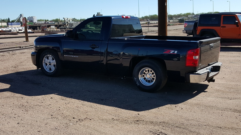

Anyone have a truck with a narrowed 8.5 10 bolt rear end?
Post a pic I wanna see offset on wheels and how much you narrowed it

Staggered 02
Feb 2013
197
Central Florida
Narrowed 6" total.

Going 5 lug and trying to get wheels and slicks tucked. Just wanted to see some more setups. I'm coil over and ladder bar setup

Yes, thanks.
373 gears, Eaton posi, Moser Axles. It runs great. Post some pictures of yours when you get a chance.

Before
121
Find More Posts by 121
Oct 30, 2015 | 05:25 PM
121
Mar 2011
435
Cheyenne, WY
After

Before ladder bar setup

I want to fill the gap

Not a 10 bolt, but my rear is narrowed 4" on each side for a total of 8". I run a 12" wheel with a 5" backspace.
