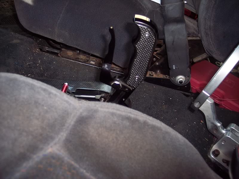

heres mine..just an arms reach for me ..excuse the mess..the truck is all torn apart..so i dont really care to clean it much at this point Name:  100_2196.jpg

Here's a Q for any to answer. Q:Has anyone tried to put a floor mt. shifter in a reg.cab, yet retain that middle jump seat? I just went out to truck & I forgot bout the cupholder on front of seat protrudes even further forward too. I kinda like the storage on the upper part of seat. A cupholder can be relocated prolly. Where's that ProShifter of mine? Hmm...

This is good...real good. I remember Silver Whistler's post. And Dirty30's was exactly what I had been looking for on the console. Floor mount good too, but I think the console looks cleaner and still have a place for all my junk.. Good to know I don't need to hook up any of the wiring, except maybe tow/haul and indicator lites. I'll admit the main idea isn't function but it does look damn good.

I removed the seat and never thought about a console, I have some pics of the install but I never to a pic of the final product. I will shoot some pics this weekend. ( truck is at my moms in storage)
