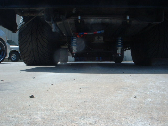

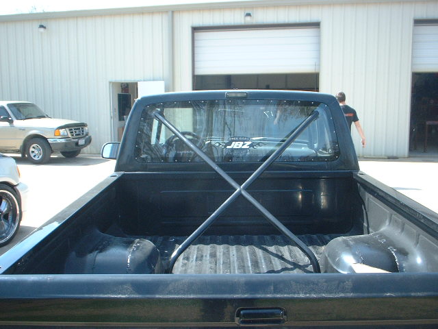

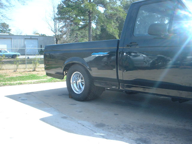

Final pics. Complete and sitting outside.
Attached Thumbnails Madman 4 link for Trucks-4-link-010.jpg   Madman 4 link for Trucks-4-link-011.jpg   Madman 4 link for Trucks-4-link-012.jpg
