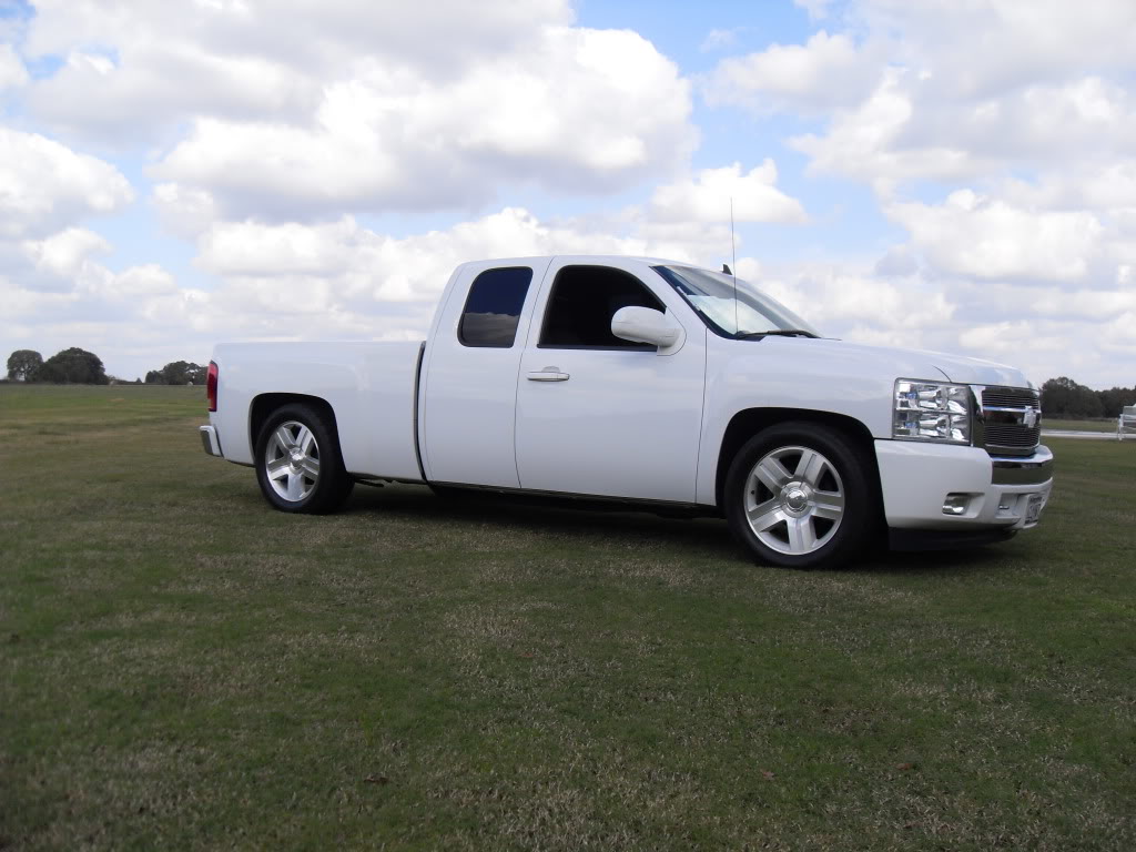

Something like this 4/7 or a little more mild would be perfect. (Pic stolen from GMFS)

If you want to do a 4/7,^^ Like chads,( I have a 4/7)
you can do spindles and struts for the front.
The rear is just a flip kit. You'll have like 2" clearance so you'll either want a c-notch, helper bags, or air shocks to minimize bottoming out.
The install is kinda time consuming. Spindle install is easy swap. Strut install you'll need a spring compressor. You can rent it for free at an auto parts.
The rear is kind of a hassle too. Either move the gas tank to reach the front spring bolt or remove the u-joint and swing the axle over the leaf springs.
As far as going back to stock. The rear would just be in reverse. The front you can just install more rings on the strut to have a 2" lift that will offset the spindles. The belltech struts are good for up to 2" lift and can go down to a 2" drop.
