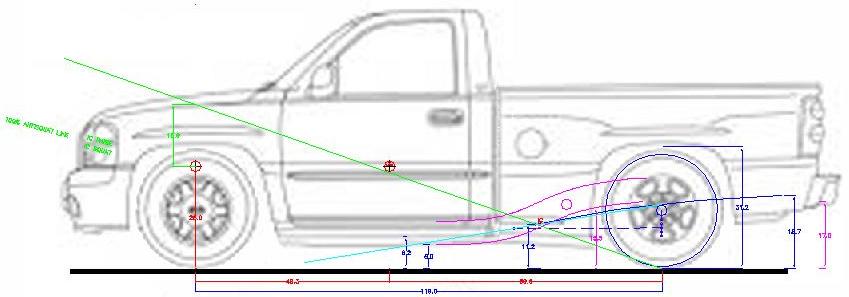

Rodney, you got these built yet? I have been doing some measuring and figuring on lengths and geometry for good anitsquat. On my truck, keeping the bars parallel to the ground, I can't go lower than 4" from the axle and the length really doesn't matter to get 100% antisquat. The length will be more instrumental in keeping the bars from binding and staying consistent with the travel arc of the leaf spring. Here is the drawing I did in AutoCAD to help me visualize the geometry.

I am still awaitng all the parts to come in. They might not help me get great 60 foot time , but it will be impossible to wheel hop with the long bars. Nice work BigKid! I hope to have these in action by the STS race November the 19th!

Just curious, what size tubing and heims are you using?
