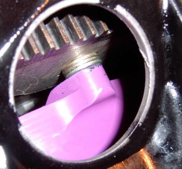

Don't know about the difference in the two flexplates but if the spacing between the flywheel and flexplate is more than 1/16-1/8" with the TC fully seated then washers are recommended. Pulling out the TC more than 1/8" will likely cause damage. Mine hasn't been tested yet but this is what I was instructed to do by Precision Industries and the tranny builder:
I bought the washers already but now L-Eater got me thinking about the 6.0 flywheel...........I mean, wouldn't it be the same if I space the TC bolts than if I space the flywheel, I really can't understand this at all ...I need to know if both flywheels are exactly the same.

The Vig gap seems to be there even with the stock 5.3 flexplates. I never touched my flexplate and others have reported the same gap. So I would think that there was something wrong if there was no gap to shim when the TC is fully seated on the input shaft.

I started the truck and holy , a fast loud cracking sound coming from underneath...I called my tranny builder and he told me some of the things that could be wrong and what do you know...............he was right, the damn black plastic dust cover that goes with the starter was crooked and the TC bolts were knocking the f@#k out of it! After that my brother and I went for some races......the camaro will have to wait .
