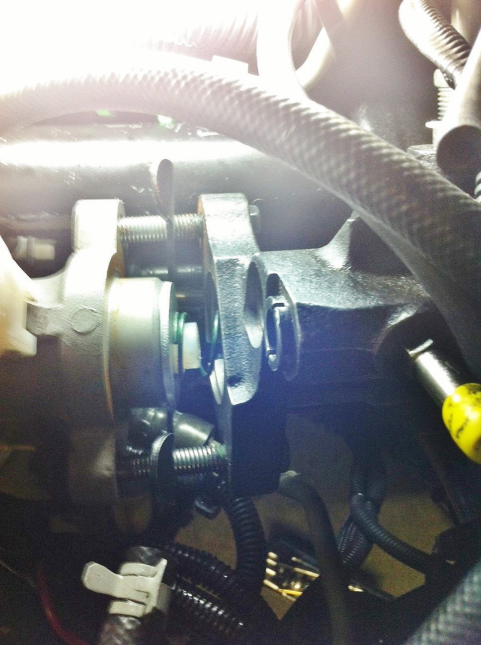

Anyone have a dead hydroboost unit lying around with a good spring retainer( star-shaped part in this pic)? Still searching for the one out of mine and the reman unit from Rock Auto came with nothing, contrary to what this pic from their website shows.

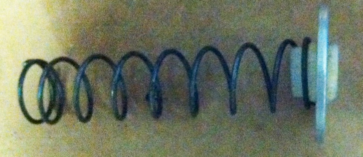

Rigged this up for now from a flat washer and a 1/2" HDPE hose coupler. Cut down the coupler, heat softened it, and rolled the end to lock it onto the washer.
