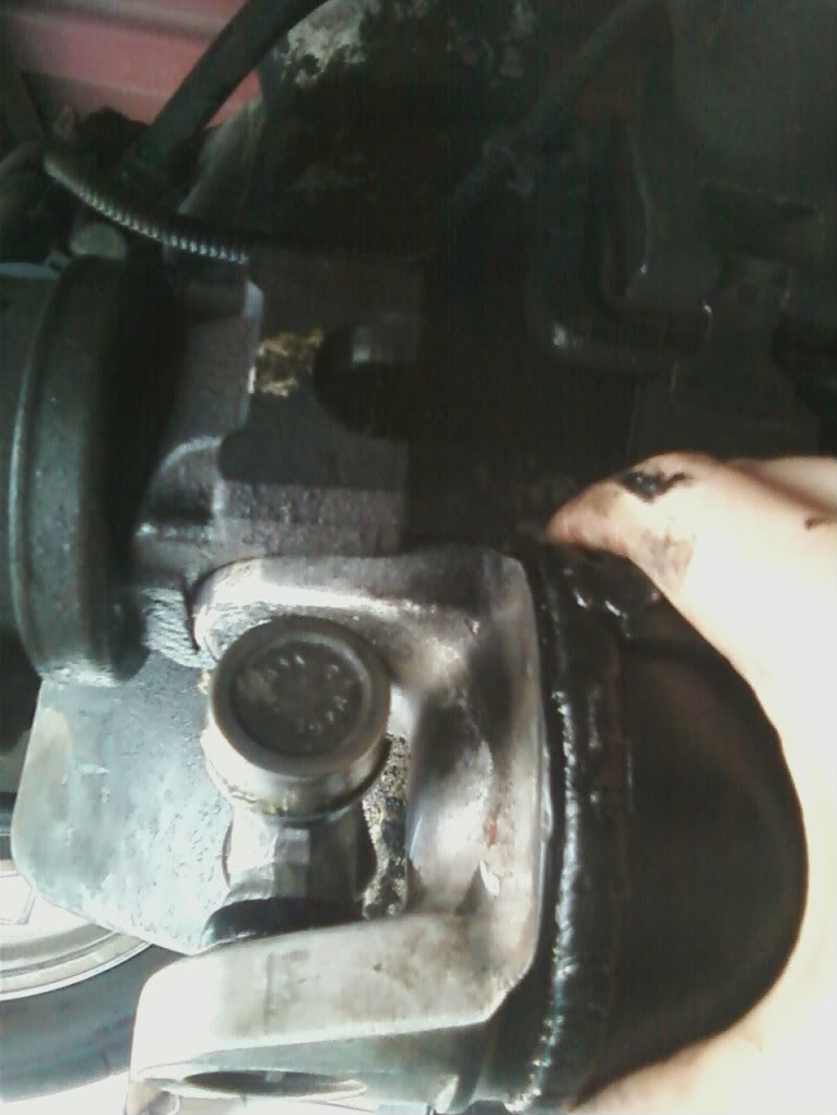

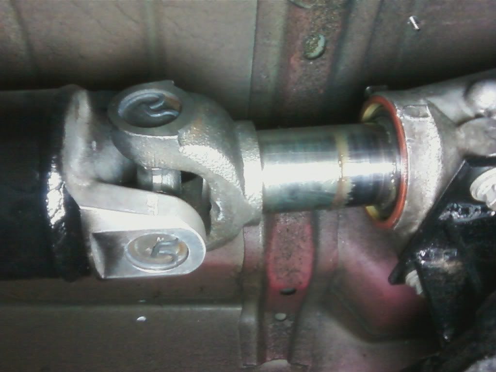

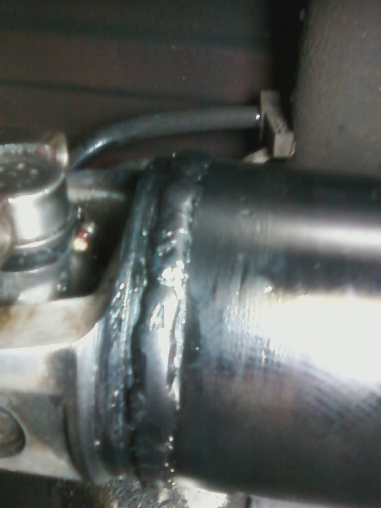

OK. Pick it up today, first it's easy to figure out which side was cut, welds were grinded down and all over. Next I notice a very large weight that was welded on. Already feeling pretty bad about deciding to go here.
Get home, nice doesn't fit.
Welds:
I messure it, it's 65" tip to tip.Not sure how a 65inch shaft fits in a 62inch length, and then a 1 1/2inch output shaft to make the gap smaller. Well, it doesn't.
Take it back, he says " how much more do you want me to take off". And I quote " I don't know, I don't build these things. I gave you my lengths. I then show him the pictures your looking at and my huge mistake say "An inch, maybe 1 1/2, 1 3/4, I just need it to slip in the rear and not bottom out.
He take an 1 3/4 off. Again, my mistake for not saying "if you cant build it base on my measurements, I shouldnt be here"
Instead, I go with that. I go back to work and come get it afterwords. Get it home, it's to short.
Now WTF. Pretty sure I have about $575 in this thing now and it's nothing but a fucked over paper weight. Should have went back with guys that know what the hell they are doing, but trusted a local shop.
