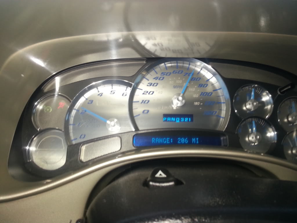

Old Apr 9, 2014 | 04:43 PM
SNKY04's Avatar
Joined: Jul 2013
Posts: 24
From: Firebaugh Ca
This is were im at with 3.73.
