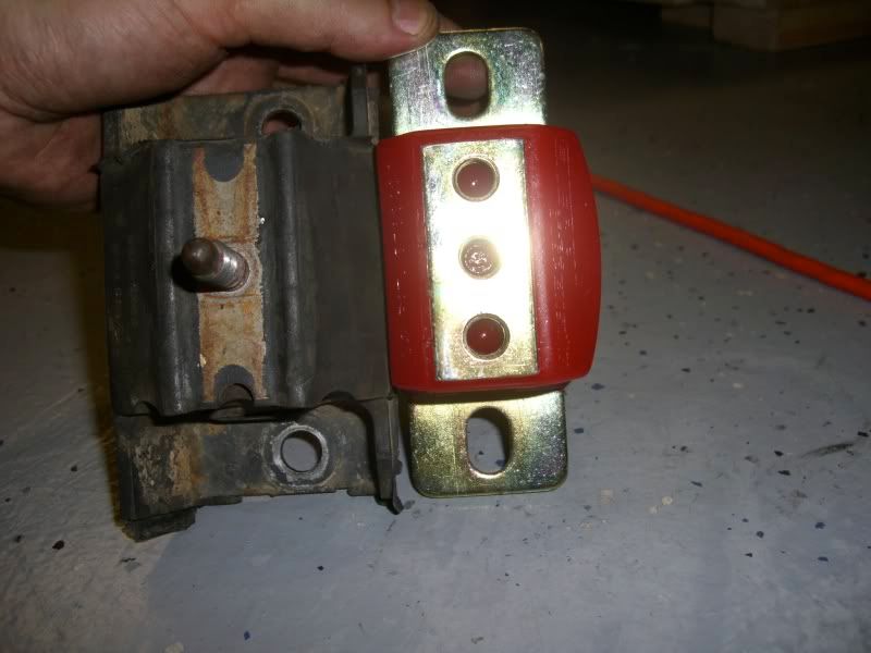

Maybe something like this.

Who makes that?
Old Dec 28, 2010 | 08:36 AM
48548's Avatar
Joined: Feb 2010
Posts: 136
From: North Phoenix
I am thinking it is Energy Suspension. I got this picture from the site you listed above.
