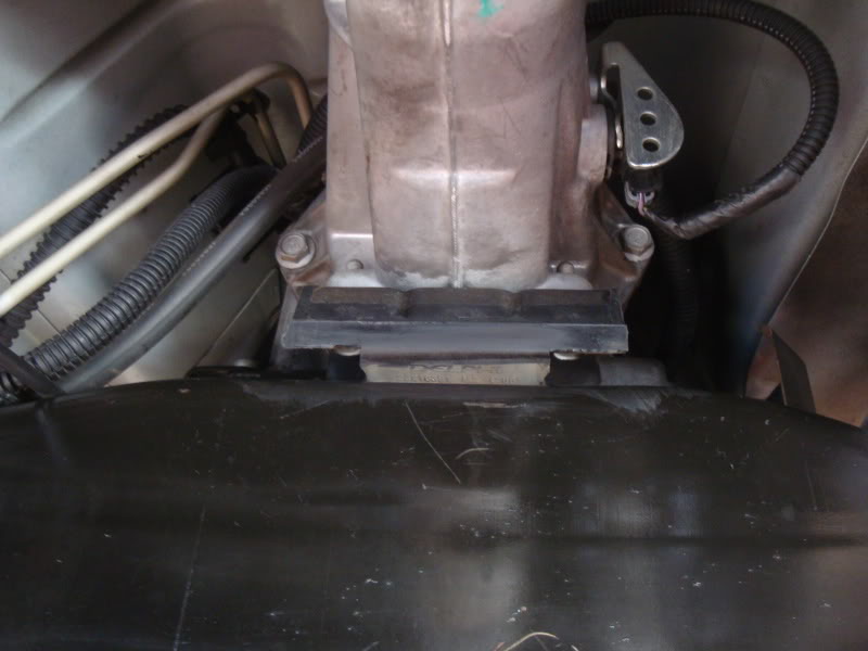

I have been a GM Technician for over 15 years now. Over the years I have seen many parts that could use some improvement. A few of which are the front sway bar bushings and the transmission mount. Well thanks to the people at Energy Suspension there are upgrades available. Today I did a few, here are some pictures.
Stock Transmission Mount
Energy Suspension Mount Installed
Stock Sway Bar Bushings
Energy Suspension Sway Bar and End Link kit installed.
Energy Suspension Part Numbers
They do not have a specific listing for the GMT900 but
these will work.
Sway Bar Bushings: 9.5172R
End Link Kit: 9.8149R
Transmission Mount: 31108

Whats the point in doing a tranny mount without doing the engine mounts as well? I know energy suspension doesn't make the motor mounts yet.
Did you just answer your own question?
The Energy Suspension Trans mount is a huge improvement over the stock
piece.
Hey Bud, No noise here, I used a thick silicone lube when installing everything.
And Energy Suspension is my neighbor out here in California. They sponsored the Camaro I built for SEMA and have been quite generous on other projects too.

I don't see how he answered his own question unless you are incenuating you have a set of poly motor mounts. If you do, how about some more info. If not, how about seeing how 'generous' ES will be to make some poly motor mounts for the 99+ GM trucks since you have an inside contact.

How new is this transmission mount from ES? I bought one of theirs last year and it didn't fit and their customer service SUCKED when I brought the issue up to them! Unless this is a new and recent design made for our line of trucks, I'm not buying...
