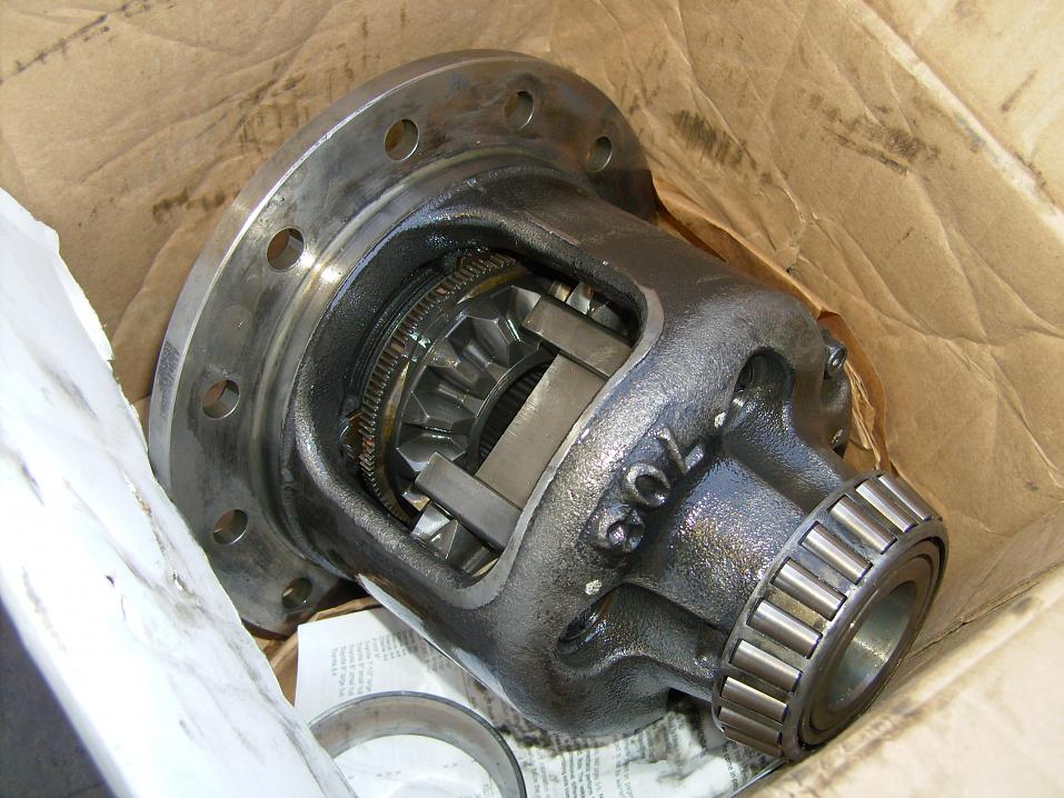

THat looks like the dif out of a '96 Impala SS/ Caprice 9C1. You can get one and install it with correct bearings........................

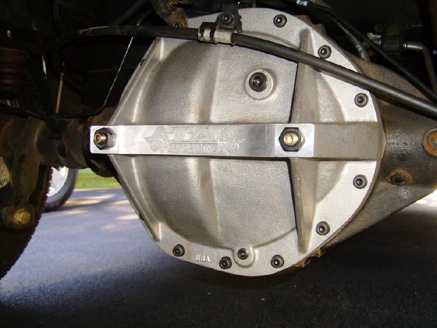

TruTrac, ARP bearing cap studs, and TA Girdle here, a worthwhile upgrade.....

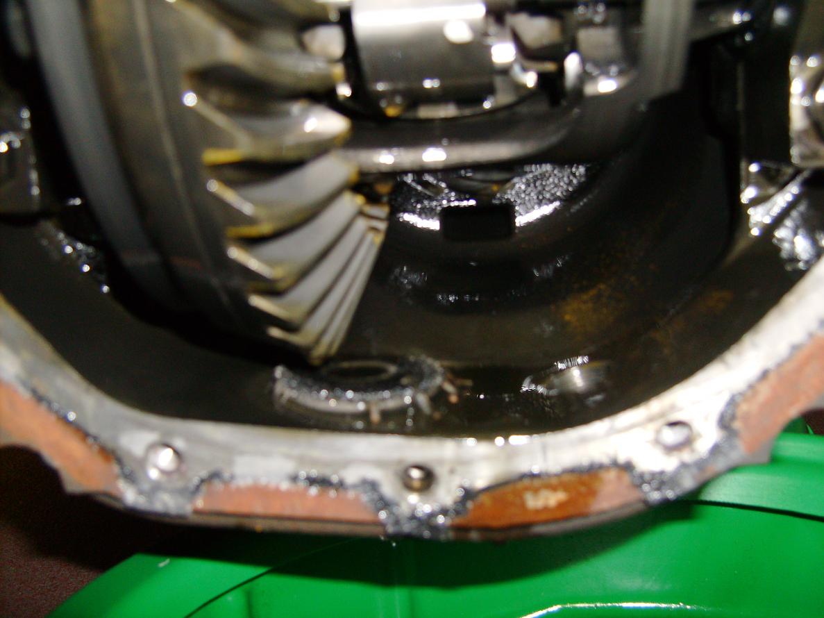

+1 for the G80 being a POS, here is my damaged unit, thank god I caught it in time before it scattered my rear end all over the road.....note the stripped teeth off the spider gear....
