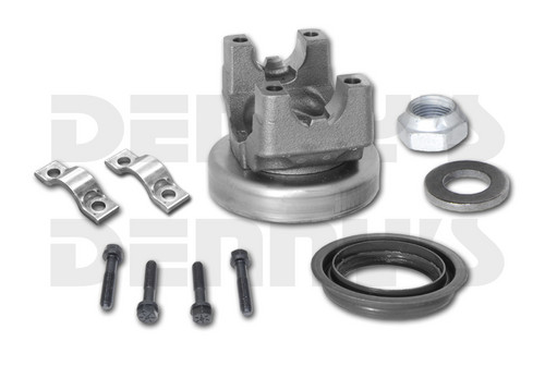

I think Denny's sells the yoke you need, it was years ago but i think I got my billet 1350 yoke from them.

It would appear you are right good sir...
http://www.dennysdriveshaft.com/p121...6_10_bolt.html

part# is spicer 3-4-8681-1,hope this helps,unless you already found it!

Thanks everyone. Got it ordered.
Now how do I calculate the tq for the pinion nut? Backlash and all that jazz. Is there a cheater way like on my GTO? Hand tight then another half turn?
Attached Thumbnails Driveshaft/U-joint question..response from Dennys-1290984819_1350seriespinionyokefor2001andnewer8_610bolt_gm8_6251.jpg
