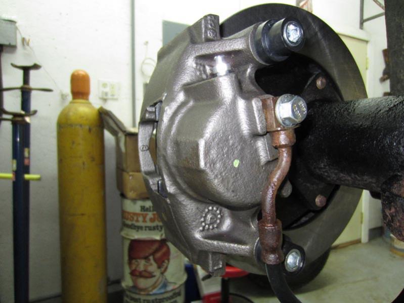

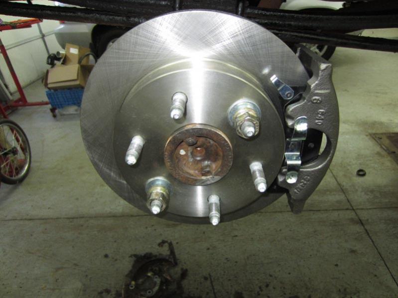

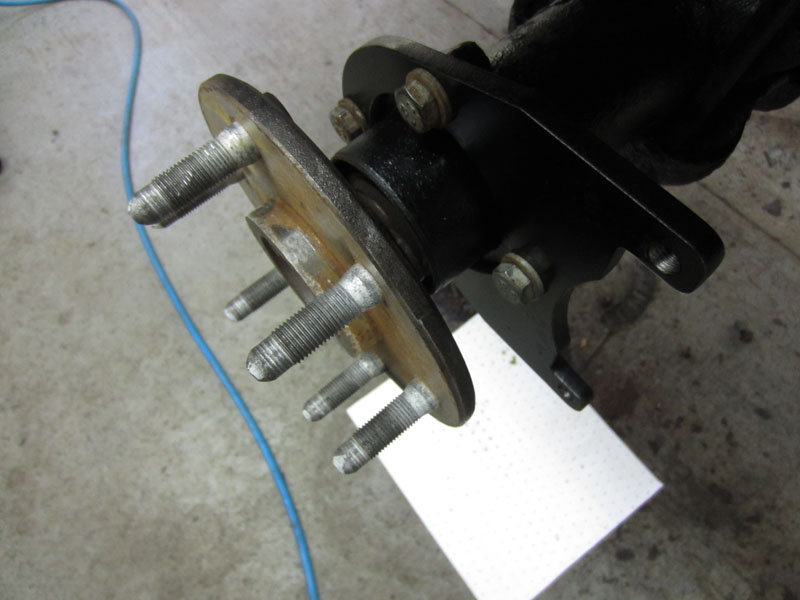

To each his own, but I have the rear converted over waiting on the wheels for all around.
Front 6 bolt Diamond wheels 1.75 offset 15x4.5 wide, the dish on the wheel center should clear the caliper bracket that sticks out. Will do control arms when I lower it.
Rear I used 90 Chevy reg cab front calipers pads and rotors mounted to a custom bracket that bolts to the 4-bolt flange. $125 at my local parts store for the brake parts. re routed the stock lines and bought the correct course thread caliper bolts. Cut the old brackets off so I never even had to take the axle shafts out or open the pumpkin.
I have 5/8" clearance on a stock 16" wheel so I should have 1/8" or better (1/2" radius) on the 15" Diamonds.
Rotors are slightly smaller in diameter than oem but the pistons in the calipers are 3/8" larger than stock so the bias is right on. Did some emergency braking and all feels just right on mine.
Here are some photos of my mock up of the rear, bracket is drawn in plasmacam.
Wheels will be done Monday.
Cheers!

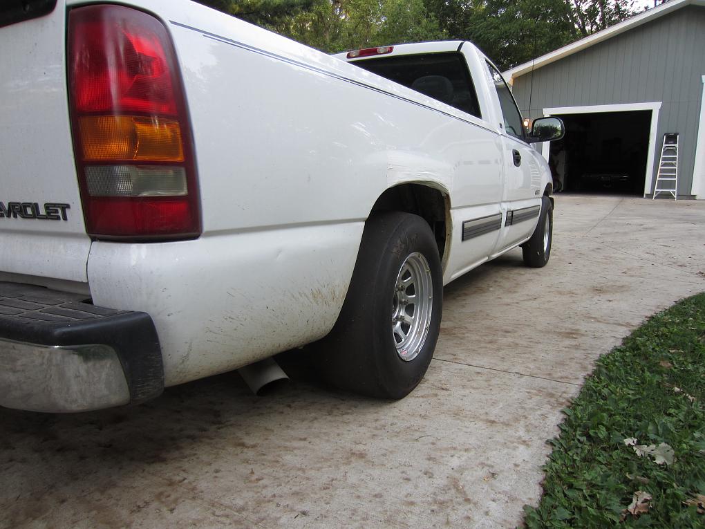

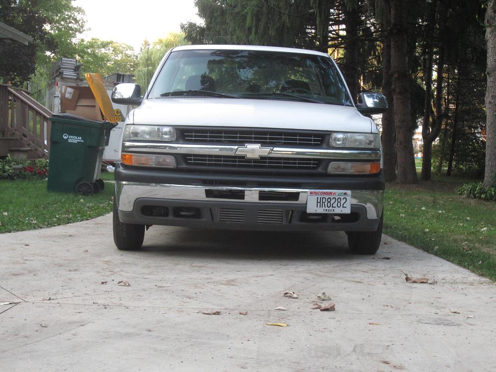

Old Aug 16, 2012 | 12:25 PM
Johnmaster's Avatar
MASS seller approved
Joined: Apr 2011
Posts: 324
From: Mukwonago, Wi
Attached Thumbnails Drag Setup w/15s-img_0594.jpg   Drag Setup w/15s-img_0596.jpg   Drag Setup w/15s-img_0592.jpg   Drag Setup w/15s-img_0591.jpg
