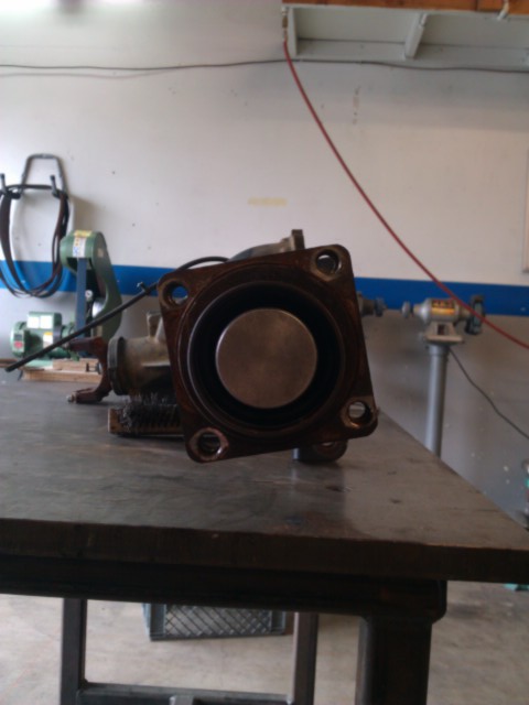

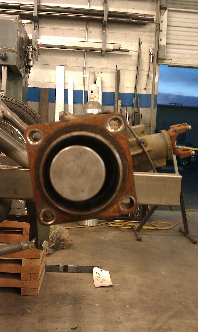

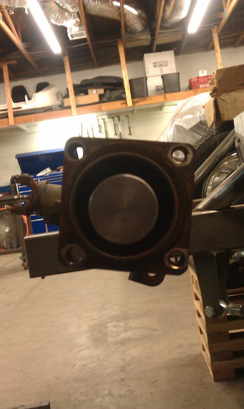

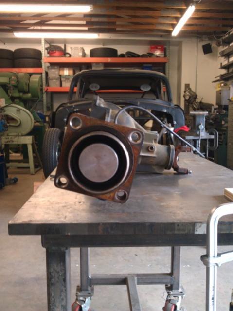

Here is a picture of 10 bolt that a co worker had. One side happened to be more extreme then the other.
Look how much the tubes are out of alignment before I straightened it.
I wish I had a picture of the axle shaft, you could see that spline on the shaft from that side, had more wear then the other side.
