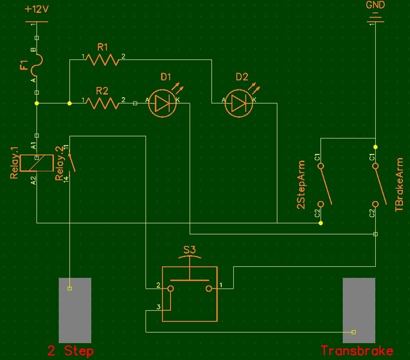

Anyone else ever have a D1 brake not want to release or delayed release? This was the first test at the track. I had both the 2 step and t-brake armed and activated by the same switch.
Line lock, 2-step, T-brake test video

Tested again with nothing but a switch between the t-brake wire and ground. On the street with street tires it instantly smoked the tires, but at the track, launching on slicks, it was still a no go until I released the throttle. Same result with either switch. On one pass it didn't release until the second time I let off the throttle. Here's my first pass. Had some other issues also as bank 1 was way rich and the ID1000s are maxed out if I run higher than stock shift points.
You can see in the log of this pass where I had to back off the throttle to get rolling.
