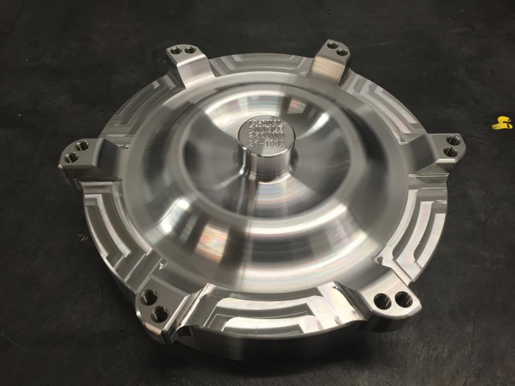

Old Jun 8, 2015 | 11:06 AM
Circle-D's Avatar
Former Vendor
iTrader: (21)
Joined: Feb 2006
Posts: 2,402
From: Houston, TX
Wd can use our Dual LS billet front, that will fit any flexplate mentioned here. It has the 4L80 and 4L60 BP and the longer LS pilot so no extender needed. Our steel SFI flexplate has 6 converter bolts on the 4L80 and 6 on the 4L60. If you want to get the TCI, get the 399754 4L80 version. That way you can use a 6 converter bolts.
