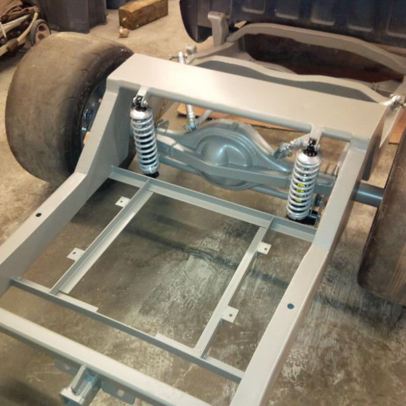

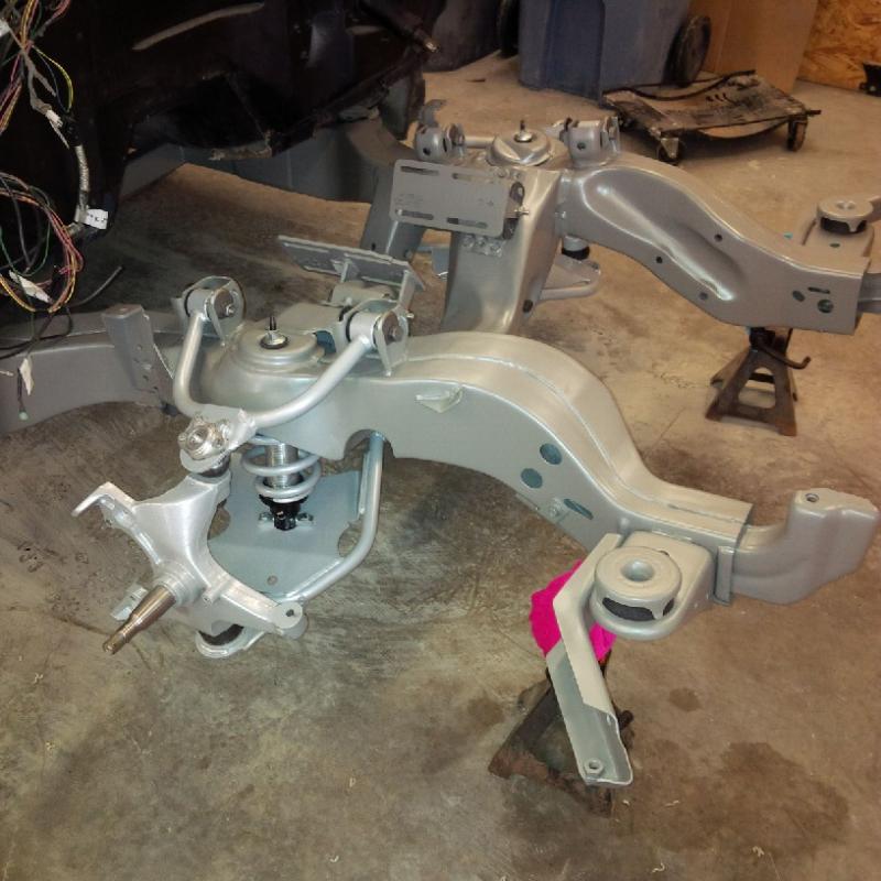

here is my brothers 92 setup with strong arms and coilovers, I do believe they are adjustable QA1
