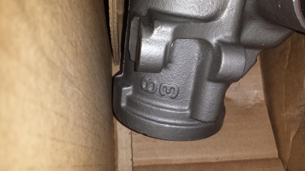

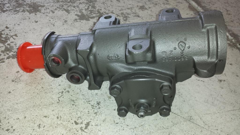

Tydriver Jun 9, 2014 06:38 PM
2 Attachment(s)
My quick ratio box showed up today.. Going to throw on a quick coat of paint and maybe get it up on the truck this weekend..
Attachment 101919
Close up of the casting mark/numbers I was talking about before...
Attachment 101920
