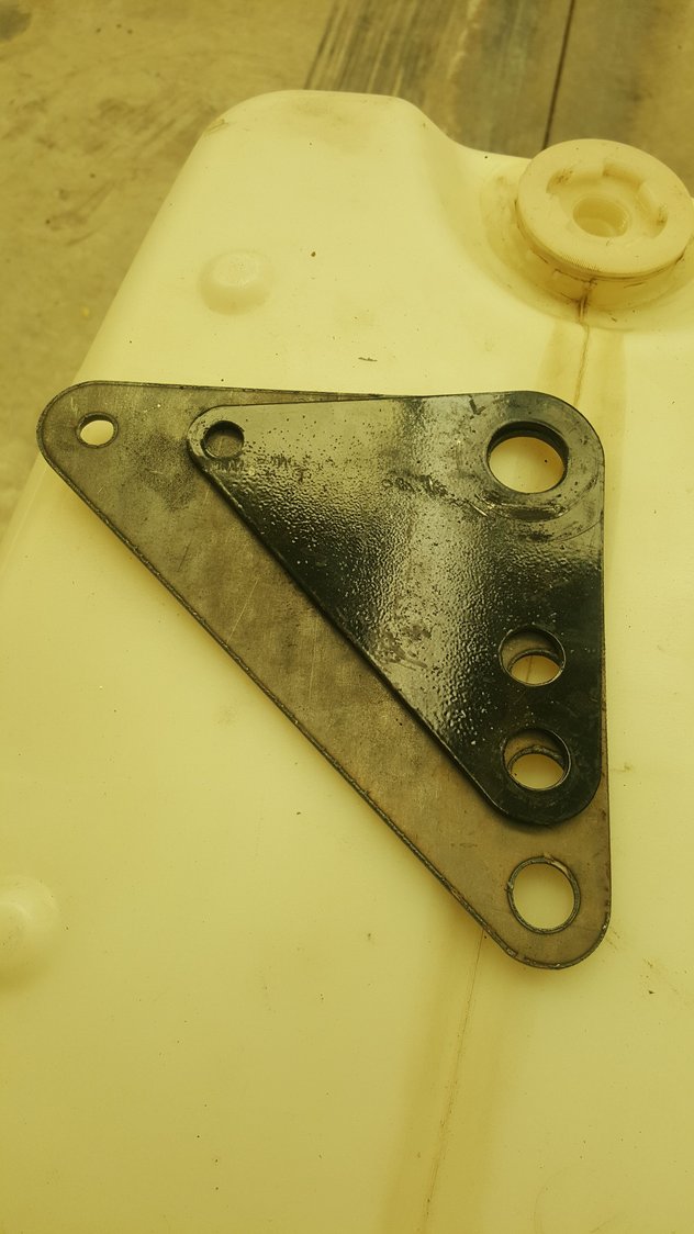

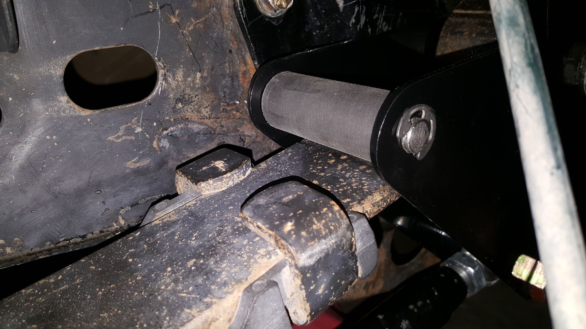

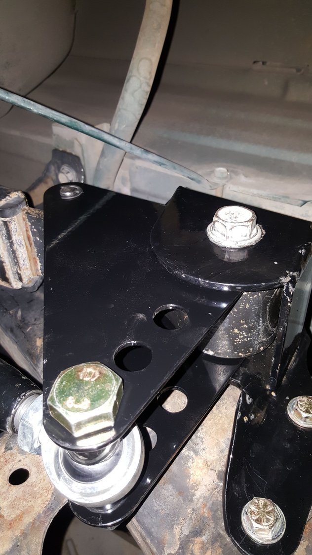

I was finally able to change the triangles and go to the track to test the truck
Best 60 feet was a 1.83 on a two step at 3000rpm and 5psi of boost at launch when on foot break my best 60 had been 1.89 and usually low to mid 90´s so im improving just not very much
This was the first time out being able to leave the line with my two step, everytime before i went up in smoke, went dead hooking 6 out of 7 runs this times
I have a video of the run where i smoke the tires where i tried leaving at 3200rpm wish made 6psi of boost and need to know what i can do to fix that, am i hitting the tire to hard? at first i tought maybe it spun only on one tire but the more i look at it it looks like the truck almost bounces in the air on the rear right when it losses traction(picture is taking out of the video where you can see the wrikles in the back tire)
slowmotion edited_zpsqsomnkyr.mp4 Video by greensss | Photobucket
Setup was:
12 psi in ET radials
both rancho 9000 shocks in position 5
traction bars both on the lowest hole and touching the springs then backed up 1.5 turns
front shocks cheap monroes
