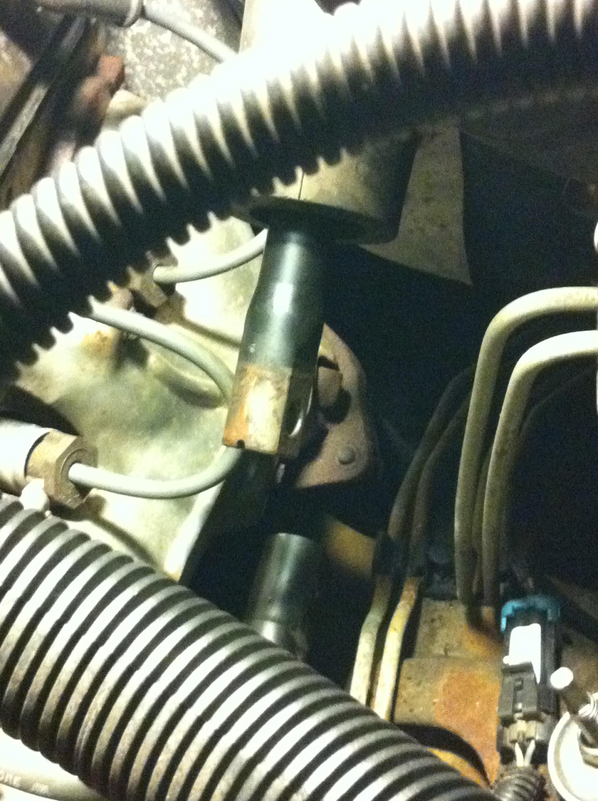

I had this issue. I crammed a **** ton of super thick Royal Purple grease up the steering tube. It has been a year without anymore issues.
