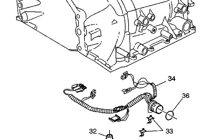

There is an O-ring on that connector:
It isn't the above VSS. I haven't torn into it but thinking about buying a new harness for it. As I said before the the connector had been hit during shipping or something and driven back into the trans. Might have cracked something internal to it??? Dunno.
It doesn't appear the the leak is coming from around the connector... The o-ring you mention. Fluid is actually traveling through the connector and exiting at the harness end, traveling along the wires. Its actually dripping from the wires on the truck side wiring harness.
