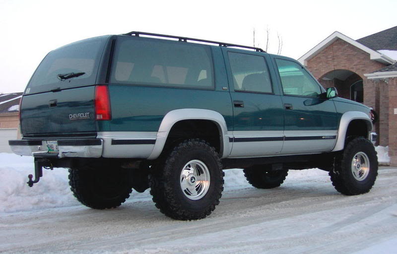

The 14 bolt FF is a beast. Had one on my old 2500 Sub. The damn drum brakes were never right though. Drums weighed a ton. The ABS unit on that thing was also monstrous. Sounded like an ooo gah horn when it activated.

Mine was a 93, 454. I ran 37's on it. ORU has a disc conversion kit for those older axles. $1000- $1500 depending on whether you want parking brakes or not.
